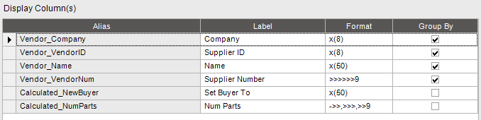

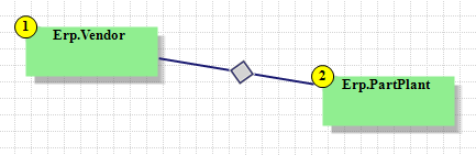

Here’s the BAQ, which just gets a list of Vendors that are currently assigned to any PartPlant records. (Just filtering out any vendors that aren’t assigned to parts, since there’s nothing to update for those vendors.)
I’m using ‘Group By’ to return a single row for each Vendor. The ‘NewBuyer’ calculated field is just blank to start, and is what gets updated to the new BuyerID. I’ve got another BAQ populating a drop-down list to ensure only valid BuyerIDs are available to choose from.
