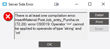

I keep getting the following error
The error seems to be associated with my query criteria. I feel like I am missing something that is glaringly obvious to someone else.
What happens when you put single quotes around your ‘160’ constant?
Yup just before you replied that is what I tried and it worked. Thanks!
Yeah, it’s one of those things where it looks like a SQL BAQ, but it’s actually C# so some of the rules change. I wish they would fix that. (by fix I mean just make a more intelligent error message, and preferably one that shows up earlier)
