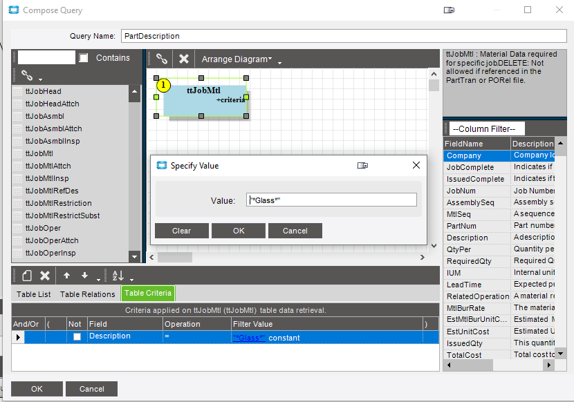

Why can’t I get this query to work?
It should be ‘Glass’ (single quotes), and I don’t know what * are going to do. Are you trying to find something that contains glass? Try Like.
When I try single quotes I get the following error.image
