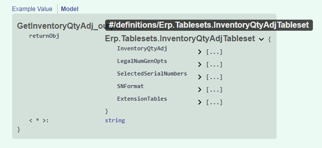

Whelp, I think the easiest way at this point would be to create a BAQ with all of the data you need, then use REST to call that.
So I can’t use InventoryQtyAdjSvc and GetInventoryQtyAdjBrw to pull in my custom field?
Not unless those service have access to the WhseBin table which it didn’t look like it did.
The method GetInventoryQtyAdjBrw must have some access to WhseBin, as it lists the bins. Could this be accomplished by using the parent/child relationships in the dataviews?
Doesn’t look like it.
You could try the Parent/Child relationship, but the problem you’re going to run into is WhseBin doesn’t have a PartNum column.
This is crazy. I’m giving up on this for now. Thanks for your help. I really do appreciate your time!
Why do two transactions when once suffices? :man_shrugging: A BAQ is also more resilient to upgrades…
