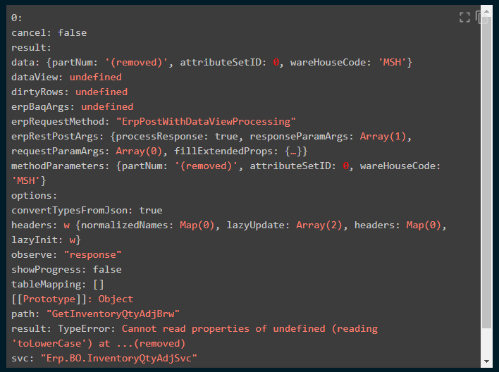

I finally got the Quantity adjust to preview in a browser. I can see in the dev tools console there is a repeatable error being generated. I will try to copy/paste it here with some additional rows. I removed part numbers and https addresses.
0:
cancel: false
result:
data: {partNum: '(removed)', attributeSetID: 0, wareHouseCode: 'MSH'}
dataView: undefined
dirtyRows: undefined
erpBaqArgs: undefined
erpRequestMethod: "ErpPostWithDataViewProcessing"
erpRestPostArgs: {processResponse: true, responseParamArgs: Array(1), requestParamArgs: Array(0), fillExtendedProps: {…}}
methodParameters: {partNum: '(removed)', attributeSetID: 0, wareHouseCode: 'MSH'}
options:
convertTypesFromJson: true
headers: w {normalizedNames: Map(0), lazyUpdate: Array(2), headers: Map(0), lazyInit: w}
observe: "response"
showProgress: false
tableMapping: []
[[Prototype]]: Object
path: "GetInventoryQtyAdjBrw"
result: TypeError: Cannot read properties of undefined (reading 'toLowerCase') at ...(removed)
svc: "Erp.BO.InventoryQtyAdjSvc"
type: "EpRestActivity-onActivity"
The relevant part seems to be - Cannot read properties of undefined (reading ‘toLowerCase’). I didn’t use ToLower anywhere that I am aware of. Should I be looking somewhere else in the console?

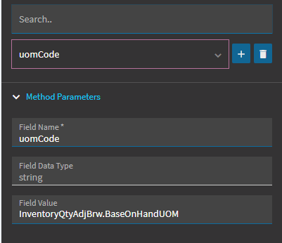

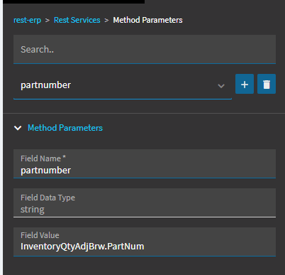

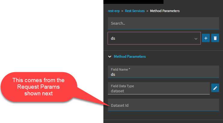

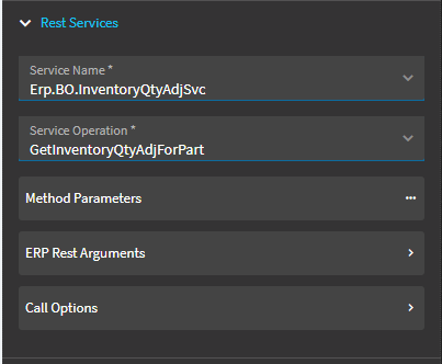

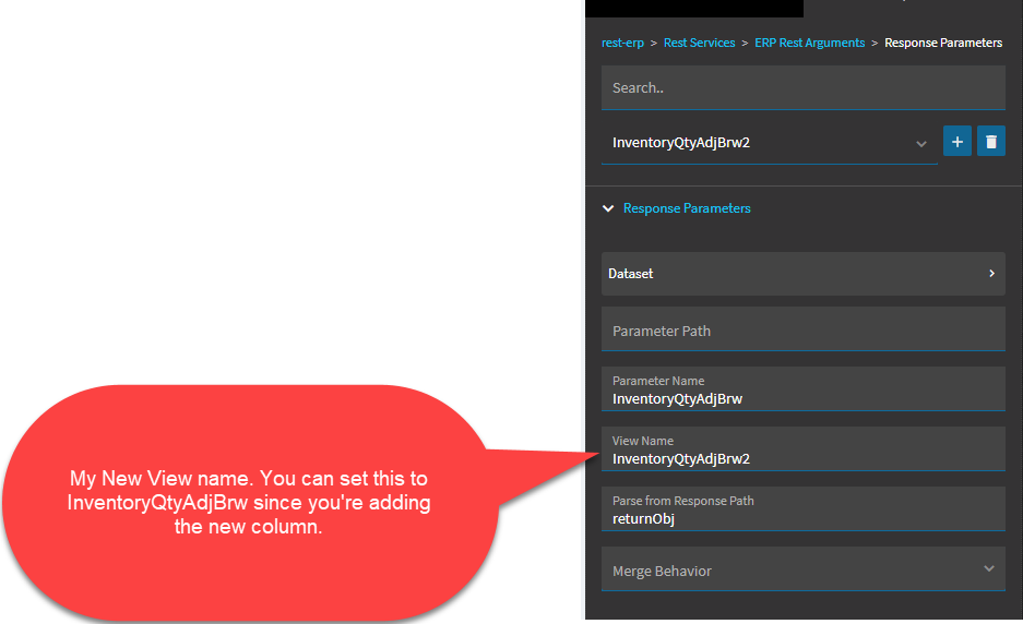

REST-ERP widget:
For this round, I setup mine just like yours. I still get that ToLower error when I trigger the event.

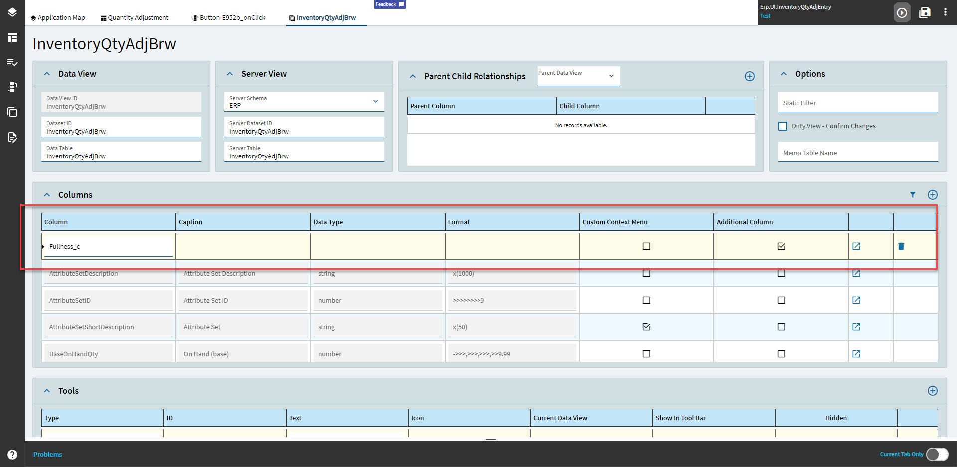

You would add it to the native InventoryQtyAdjBrw dataview like so:

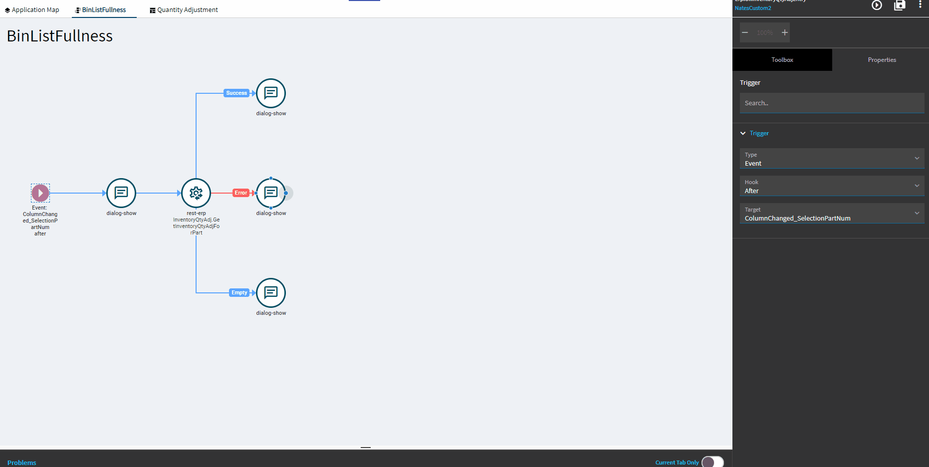

I am confident my event triggers properly. I have tested it extensively with dialog boxes. Here is a screen capture of my REST ERP.
kineticevent
I still get the REST ERP resulting in error, pointing at the mysterious ToLowerCase.

First, add your column to the InventoryQtyAdjBrw dataview. You’re also going to create a new dataview for WhseBin (fill all fields with WhseBin).
Next, you’re gonna call the Erp.BO.WhseBinSvc rest-erp and within the response params, set the Param name to WhseBin, ViewName to WhseBin, and the path to returnObj.
Then you have to set up an iterative event with row-updates to take the data from the WhseBin dataview to the InventoryQtyAdjBrw dataview that has your new column.

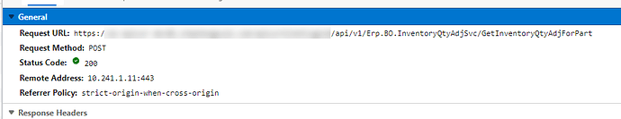

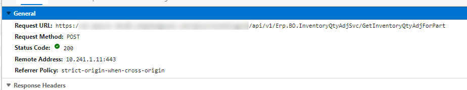

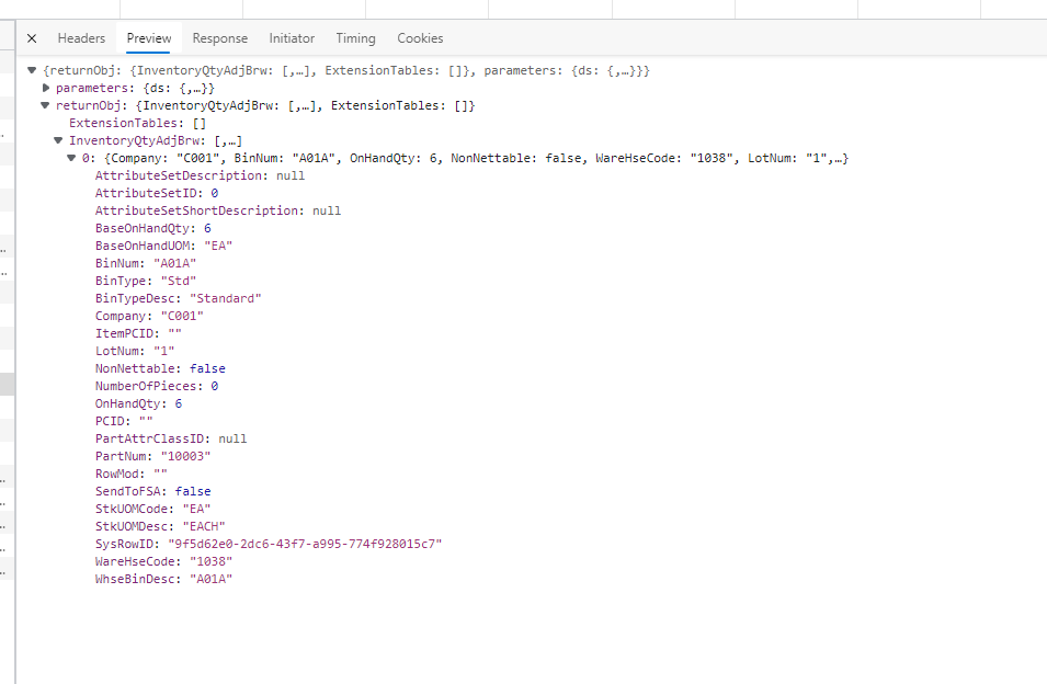

When you run it, can you go into Dev Tools and go to the network tab? Do you see a call for GetInventoryQtyAdjForPart? Does it have a response?
Yes, I see the response, and in it, I can see all the expected rows I would see in the grid. Although it is missing my Fullness_c field.
{returnObj: {,…}, parameters: {ds: {,…}}}
returnObj: {,…}
ExtensionTables: []
InventoryQtyAdjBrw: [{Company: "VTAERO", BinNum: "C", OnHandQty: 1, NonNettable: false, WareHseCode: "MSH",…},…]
0: {Company: "VTAERO", BinNum: "C", OnHandQty: 1, NonNettable: false, WareHseCode: "MSH",…}
1: {Company: "VTAERO", BinNum: "H1", OnHandQty: 1, NonNettable: false, WareHseCode: "MSH",…}
2: {Company: "VTAERO", BinNum: "H1", OnHandQty: 1, NonNettable: false, WareHseCode: "MSH",…}
3: {Company: "VTAERO", BinNum: "h1", OnHandQty: 82, NonNettable: false, WareHseCode: "MSH",…}
4: {Company: "VTAERO", BinNum: "h1", OnHandQty: 8, NonNettable: false, WareHseCode: "MSH",…}
5: {Company: "VTAERO", BinNum: "HFA", OnHandQty: 17, NonNettable: false, WareHseCode: "MSH",…}
6: {Company: "VTAERO", BinNum: "hfa", OnHandQty: 24, NonNettable: false, WareHseCode: "MSH",…}
7: {Company: "VTAERO", BinNum: "HFA", OnHandQty: 49, NonNettable: false, WareHseCode: "MSH",…}
8: {Company: "VTAERO", BinNum: "HFA", OnHandQty: 35, NonNettable: false, WareHseCode: "MSH",…}
Details for one of the rows:
AttributeSetDescription: null
AttributeSetID: 0
AttributeSetShortDescription: null
BaseOnHandQty: 1
BaseOnHandUOM: "EA"
BinNum: "C"
BinType: "Std"
BinTypeDesc: "Standard"
Company: "VTAERO"
ItemPCID: ""
LotNum: "VATESTLOT1"
NonNettable: false
NumberOfPieces: 0
OnHandQty: 1
PCID: ""
PartAttrClassID: null
PartNum: "(removed)"
RowMod: ""
SendToFSA: false
StkUOMCode: "EA"
StkUOMDesc: "Each"
SysRowID: "bd536ac1-93cc-4640-9df5-573f93375ef2"
WareHseCode: "MSH"
WhseBinDesc: "MS HARDWARE - C"
