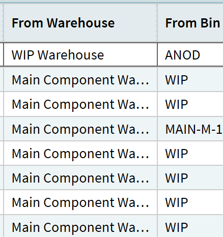

So I am stuck about 1/2 way on attempt to default the From Warehouse and From Bin columns in the Material Issues Grid to our “WIP”. (Mass Issue to Msg > Enter Job# > Click Issue Assembly button).
I tried a BPM on BuildMassIssueBrowse, which I found was what setup the grid data. However, only the post process has the actual collection and modifying in post doesn’t update the UI.
So I turned to using events, and found the below post on how to use an iteration to loop through all the rows of the grid:
What was odd though, is it looked like the code would skip the first row of grid, so I added a row-update after the dataview-condition as I knew that would update the first record.

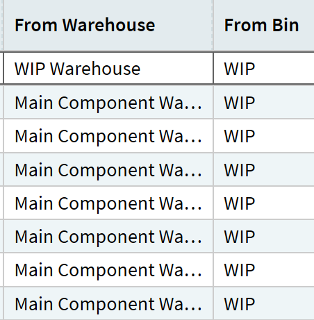

And while the From Bin is updating (screenshots below to example things), the dropdown is not. I am not sure if that’s because of the nature of how events work and changing the underlying binding value won’t update the dropdown in a grid?
I am stuck, so I hope someone can shed some light on this. As I mentioned, below are screens to example the workflow items and also show what the grid columns looked like before and what they look like now. Thank you for your help and time!
Before grid column update:
After grid column update:

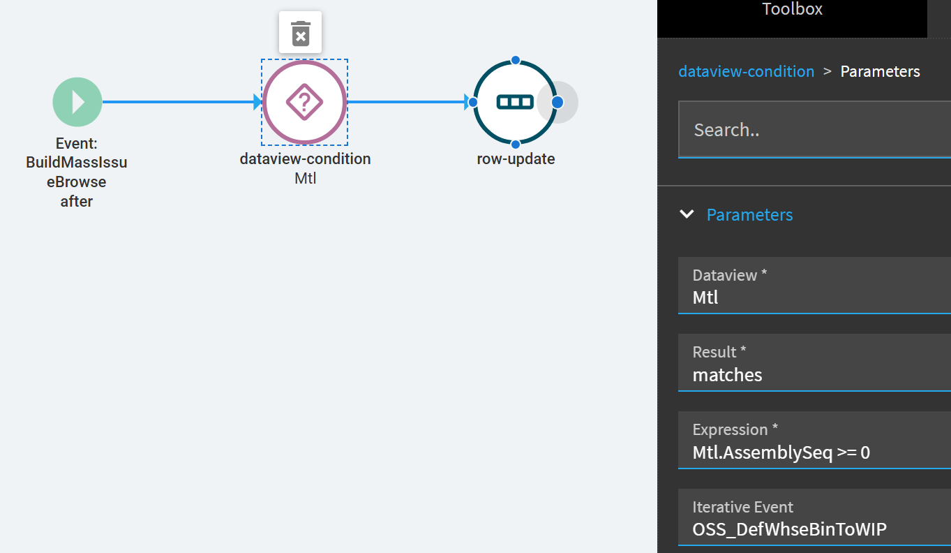

Our first event:
The expression was something I came up with to ensure I capture all rows. For my test case, all rows had an Assembly Seq of 0.

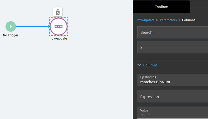

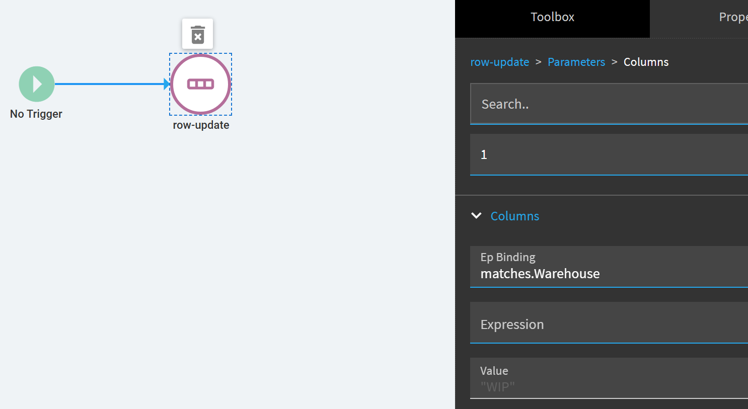

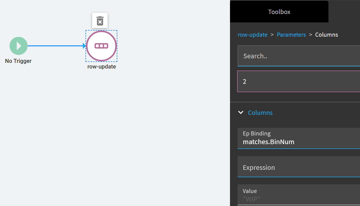

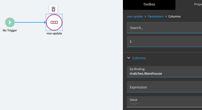

The second event that is for the iterative event, OSS_DefWhseBinToWIP, updates the two columns:
So I’m thinking this approach won’t work… something with the combo. I added a message handler to show me the value beforehand to make sure I am setting it correctly and I am so…

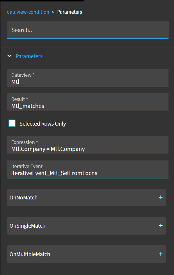

Did you resolve this? I’m trying the same thing (I think), I want to set the From Warehouse and bin for all lines by pulling values from combo box controls where the user selects the warehouse and bin. In my case, my dataview event is only updating the selected line in the grid. These are the parameters I’m using in the dataview-condition widget.
