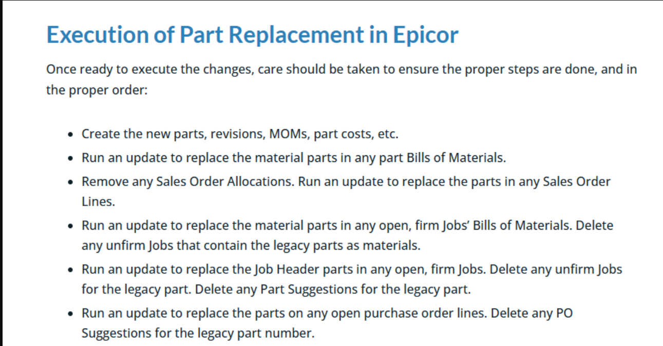

We recently checkout some parts in the engineering workbench. Is there a way to update orders to reflect the latest version? We have an order that was converted from a quote, and it defaults to revision 1
It says “run an update” like it’s a built-in tool you just click and run. I am pretty sure this means figure it out yourself! Find each of the sales orders you have, and manually open each one and update the part revision. If you already have jobs with this demand, you may need to remove the demand. And of course, all those steps you posted apply as well.
Thank you, Nate. When and why would I need to remove the demand from the job?
I am not sure on that part. You can tell with some testing. Sometimes you can’t make changes to the job until there is no demand on it.
