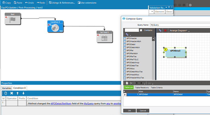

We have some government requirements were we need certain verbiage on purchase orders for military contracts and we are trying to automate this process. We are wanting to add additional comments on the PO Header when any line item on the po is in a certain product group.
I tried utilizing the set field in the update method directive on the po header and even though the temp table is there for the PO Header the field isn’t updated. I’m assuming this is because it is only updating the po detail record and not the header even though the header temp table is there.
Are there any best practices or recommendations on update header records when details are updated so that records locks and the dreaded row changed popup are avoided?

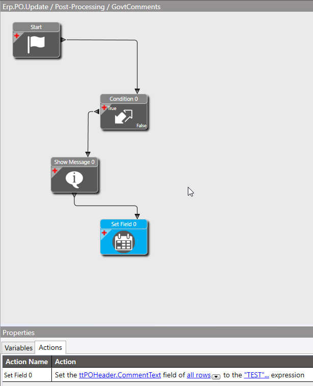

I got the following working (haven’t fully tested all possibilities: new , changed deleted, etc…)
  • “Show Message 1” is just for debugging

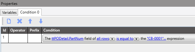

“Condition 0” does the check on PODetail (in my example it chacks if the PODetail.PartNum is a specific number)
  • “Show Message 0” and “Show Message 2” are just for debugging
The “Set Field 0” widget is:
with the expression:
ttPOHeaderRow.CommentText + "\nComment updated: " +  BpmFunc.Today()
That’s just to add something to it so I can tell it fired.

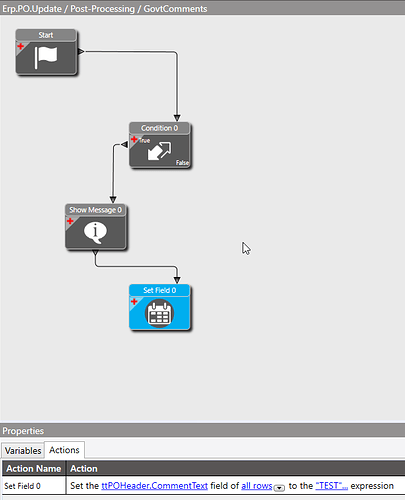

Odd, Your code is pretty much doing the same as mine. When the post process runs for me it actually updates the comment on the header in the screen, but doesn’t write it to the database on save so unless I back, edit a field on the header, then save again the comment isn’t committed to the database this way.
I think after setting the ttPOHeader, we need to call the PO.Update BO.
Might need to add something to prevent a circular reference - since PO.Update is being called from inside a PO.Update BPM. Maybe the fact that it only gets called if the Condition is true, which it shouldnt be on the second call.
