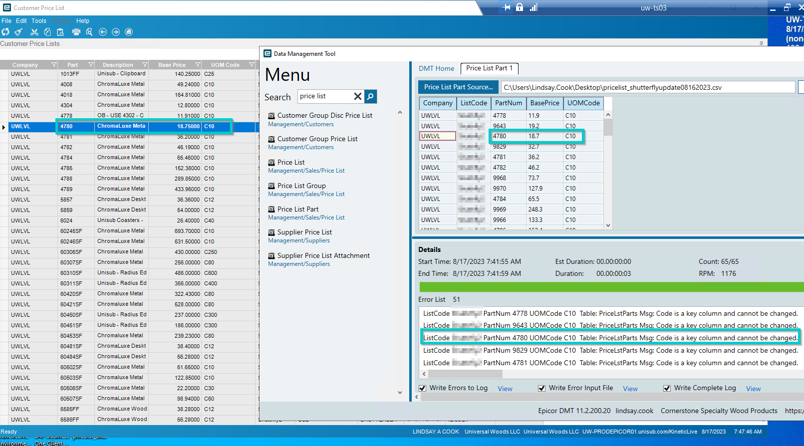

We have a large number of custom price lists for customers. To keep the number of people with access to some of the data that is also found in customers, we are managing the price lists through IT. I thought I had sorted out an issue that keeps happening with updates to prices where it errors out do to trying to “update” the UOM.
I would agree with the message. UOM is a key column and should not be changed. However it is also a required column for this DMT type. I have forced the part number field to “text” as a work around previously but seem to have this ongoing issue. I did put in a ticket to Epicor. That didn’t seem to go anywhere. Any other suggestions?

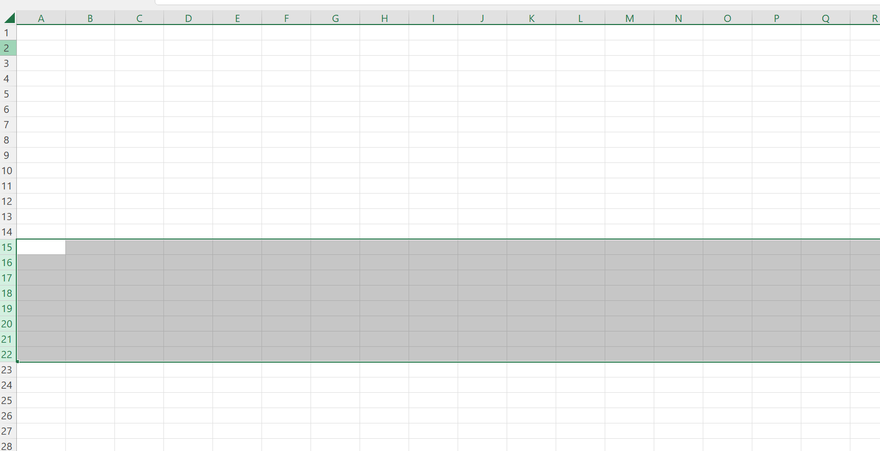

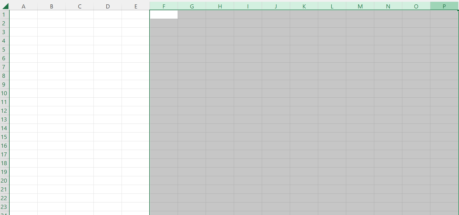

Here is the thing, sometimes when copying and pasting info in apps like Excel, you might activate unnecessary columns, let’s say column 7 for example.
You will not see anything there after deleting the value, but the column is still active.
So my suggestion is that try this:
Select the 6th column (which should be empty) and select next few columns (lets say up to column 15).
When selected, just hit delete button on your keyboard.
Do the same thing for the rows as well, find the last active row, and delete the next few rows.

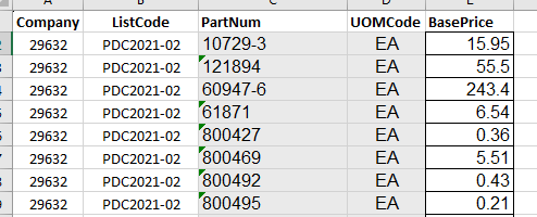

So I purposely start with a template out of DMT instead of the file provided by the end user. Then I can manage what the column headers are and not run into these issues like you have listed. I am using a .csv file.
I paste values only from the provided files to eliminate any other issues.

The dashboard shown in the original image, only returns active price lists so the list code should be good. I just don’t like manually updating 50 lines of a price list.

I found it here:
Just a question, what is “Code”?
The DMT you show has ListCode and UOMCode but not just “Code.”
It sounds like you all are assuming it is UOM?
Edit: I did look at times when I have added, modified, and deleted price list parts, and I seem to have the same template as you:
Both of those fields cannot be changed. They are both key fields for the table.
Well sure, I’m just saying that the error is vague. Maybe it’s implying something else.
If the listcode is something else then it would be a different price list overall. The structure here is weird in that you have a price list (header), price list parts (parts on the price list) and then a customer cross reference to the price list. The list code is the link between price list and price list parts.
The UOMCode is not editable manually or otherwise. That’s why it would be my assumed choice based on the error message. The only way I know of to change it would be to delete the line all together and redo it with the right UOM.
In the Field help the column label for ListCode is Code and the column label for UOMCode is UOMCode. I know they don’t necessarily match up but they are the same.

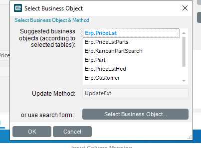

This issue is trying to use the PriceLstParts BO. It simply isnt written to update. Instead you must use the PriceList BO.
To be clear, @Chris_Conn helped me with a work around of an updatable dashboard since DMT is being a pain.
