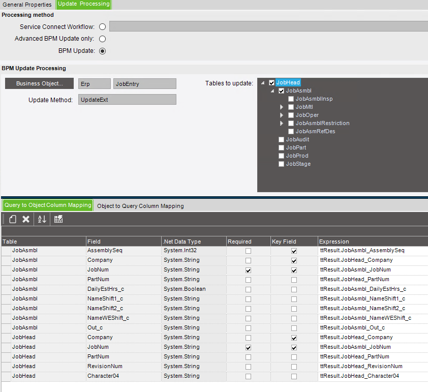

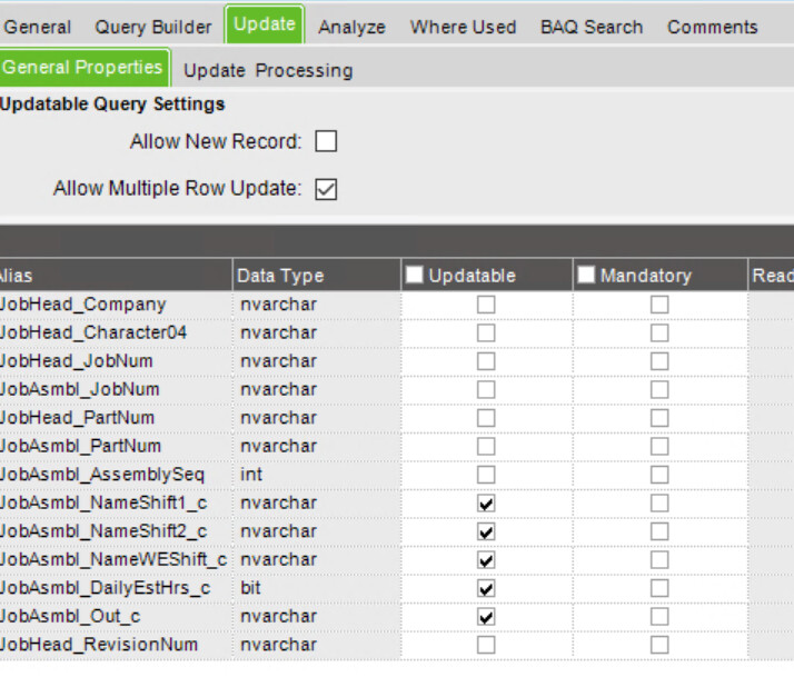

I have an updateable BAQ with the jobhead and jobasembl tables. I am trying to update some UD fields on the jobasembl table. The data shows on the BAQ Query results screen ok but when I try to update the fields the assy (1,2…) part number changes to the assy 0 part number and I get a circular error reference. Everything works fine if the assy number is 0.

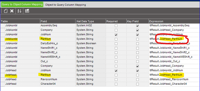

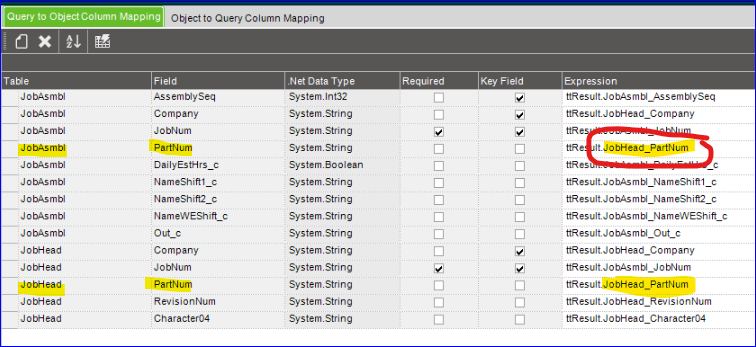

I’m very inexperienced with UBAQ’s… but it looks like you have your JobHead_PartNum mapped to you JobAsmbl_PartNum… I’m assuming that’s why it is overwriting.
I was just screen-shotting to show the same thing. I think that will resolve the error.
Thank you, that fixed it. Sometimes you go cross-eyed after looking at BAQs for so long :slight_smile:
