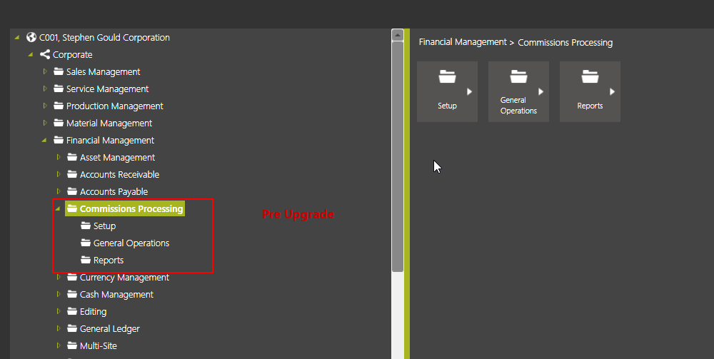

Just curious if anyone has seen this behavior. Upgrading to 2.500.X from 2.300.X
We had created a bunch of new menu’s including brand new Menu Branches and a slew of those are simply GONE after the upgrade…

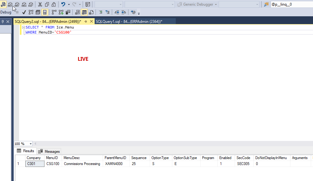

Is it gone from Menu Maintenance as well and/or Ice.Menu table?
Yes Gone from the tables and menu maintenance. POOF Evaporated @Jonathan
