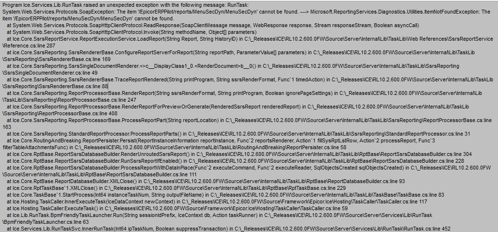

I need a menu audit security report so was told to upgrade to 10.2.600. I have navigated through the upgrade but now am receiving the below error and not sure where to turn.

That didn’t work. I am being told by Epicor that the report I’m looking for is not in the pilot db.
Do other standard reports work?
Can you go to the ssrs server /reports site and drill down to the report
