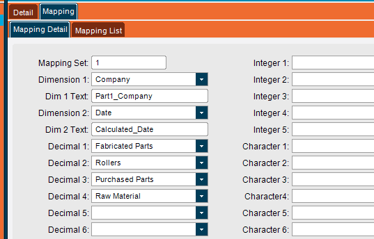

The Company would be DIM1 and Date DIM2
The four columns would be integer 1, 2, 3, and 4

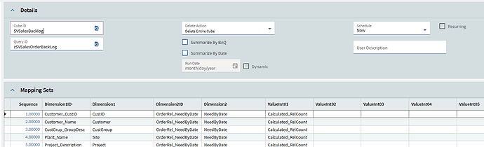

I think I see how this can work but I’m not getting it. I built my Cube and mapped it as you said. I’m stuck after that. How do I tell it to populate my UD01 table? I know I have to add this as a task and then to a process set but I’m stuck fleshing out the cube and the next query.
Here’s my cube:

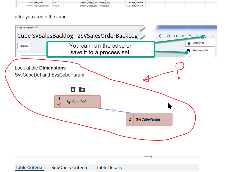

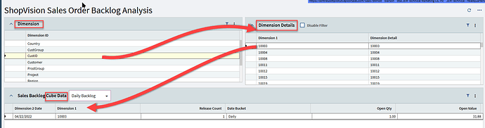

I reverse engineered one of the Shop Vision dashboards.
This helped explain how you can have multiple roll up’s of the data.
after you create the cube
Look at the Dimensions
SysCubeDef and SysCubeParam
Create a seperate BAQ for the Dimension Details
SysCubeDim
then use a BAQ to review the Cube Data
SysCube
Using Publish and Subscribe in the dashboard - you select a parameter and filter the data results.

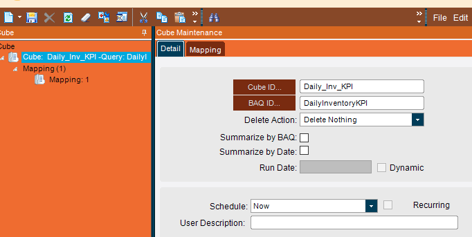

In your scenario if you are just doing a single dimension which the fabricated date (Dim2) you don’t need the other baqs for your analysis.
Just bring in SysCube filters for CubeID = “Daily_Inv_KPI”
This will give you the daily value of the various

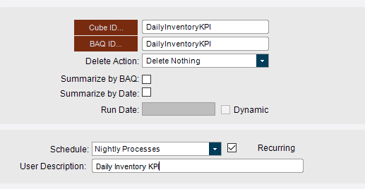

Create a process Set “DailyInvKPI”
When you are in the Executive Cube, click on Save Process Set
It will save the cube to a process set to be run
Schedule the process Set against a systemAgent schedule for a daily run.
The results will be stored in SysCube - Not UD01.
You can have multiple results in SysCube - they are all segregated thru the CubeID

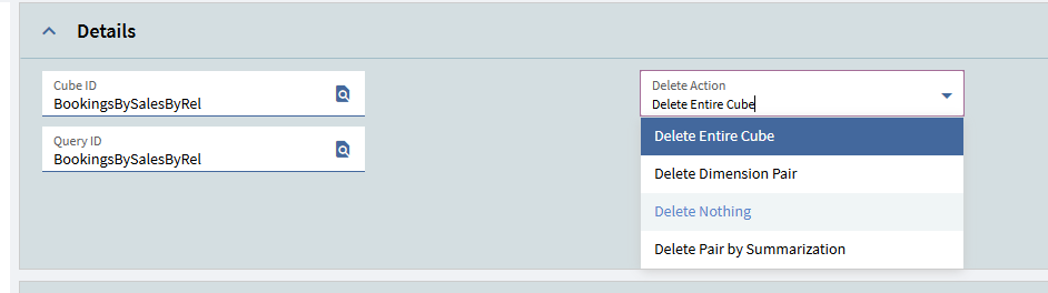

The data can be added if you delete nothing.
Each time the Executive Query is run, it adds a row of data in your case for each day.
I have also added the data to the SysCube data from a UD table for historical balances for example.
Just create another Cube that has the same Cube ID change the baq to one that is pointing to using the UD Table. Run this once to pull in the historical data.

Great, thanks! I think I’ve been setting it up wrong since my dashboard isn’t updating. I added the cube direct to the system agent task instead of saving it to a process set and putting that on the system agent to run.
The system monitor shows the cube process ran last night but the dashboard didn’t update with new data.

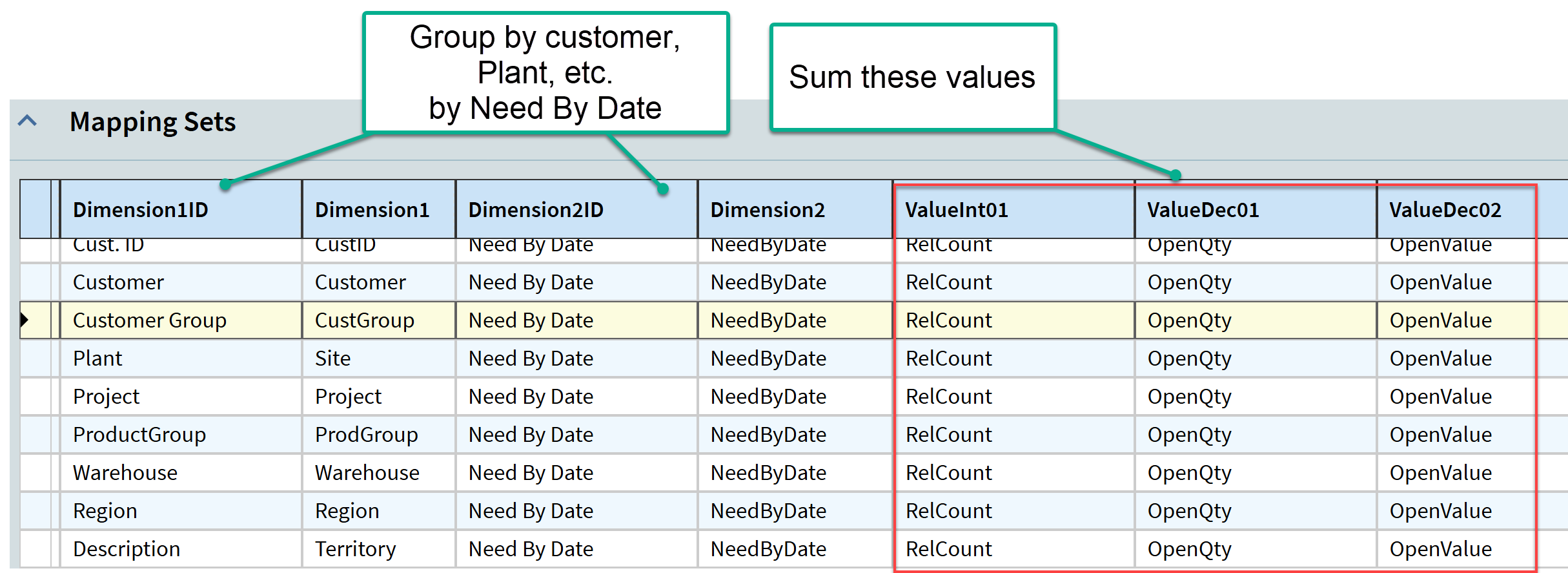

Note that the executive query sums the fields selected.
So you just need to put in OpenQty as a value not an aggregate
See the document from 2017 on how to do a cube.
Using Sales Order Backlog - note that Group By is not being used.
The GroupBy is done in the executive cube.
