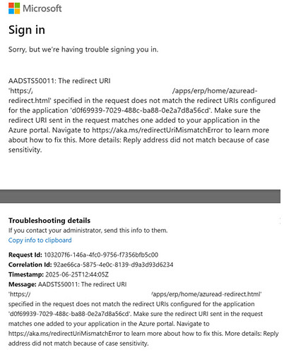

URL link created to access Kinetic on phone now erroring after SSO implementation
Cloud based and The link below was created to allow some users to do stuff in Kinetic via a phone. It used to work, until SSO was implemented. Since then, it will not open Epicor. Below is a screenshot of the Error.
Looking up the error myself, Microsoft shows a way to fix the error via accessing the Azure portal, so we assume Support will need to take a look?
Any guidance is appreciated,
B-
You need to add the redirect URIs to your app registration in Azure portal. Keep in mind that the URIs are case sensitive, so you may need to add more than 1 with different variations in case.
