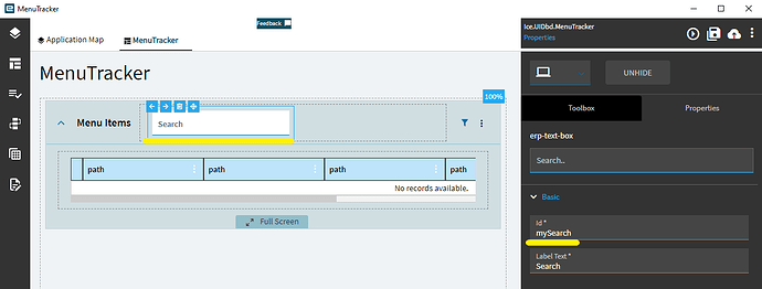

I’m making a kinetic dashboard and I’m trying to filter my BAQ with whatever value is entered in this textbox.

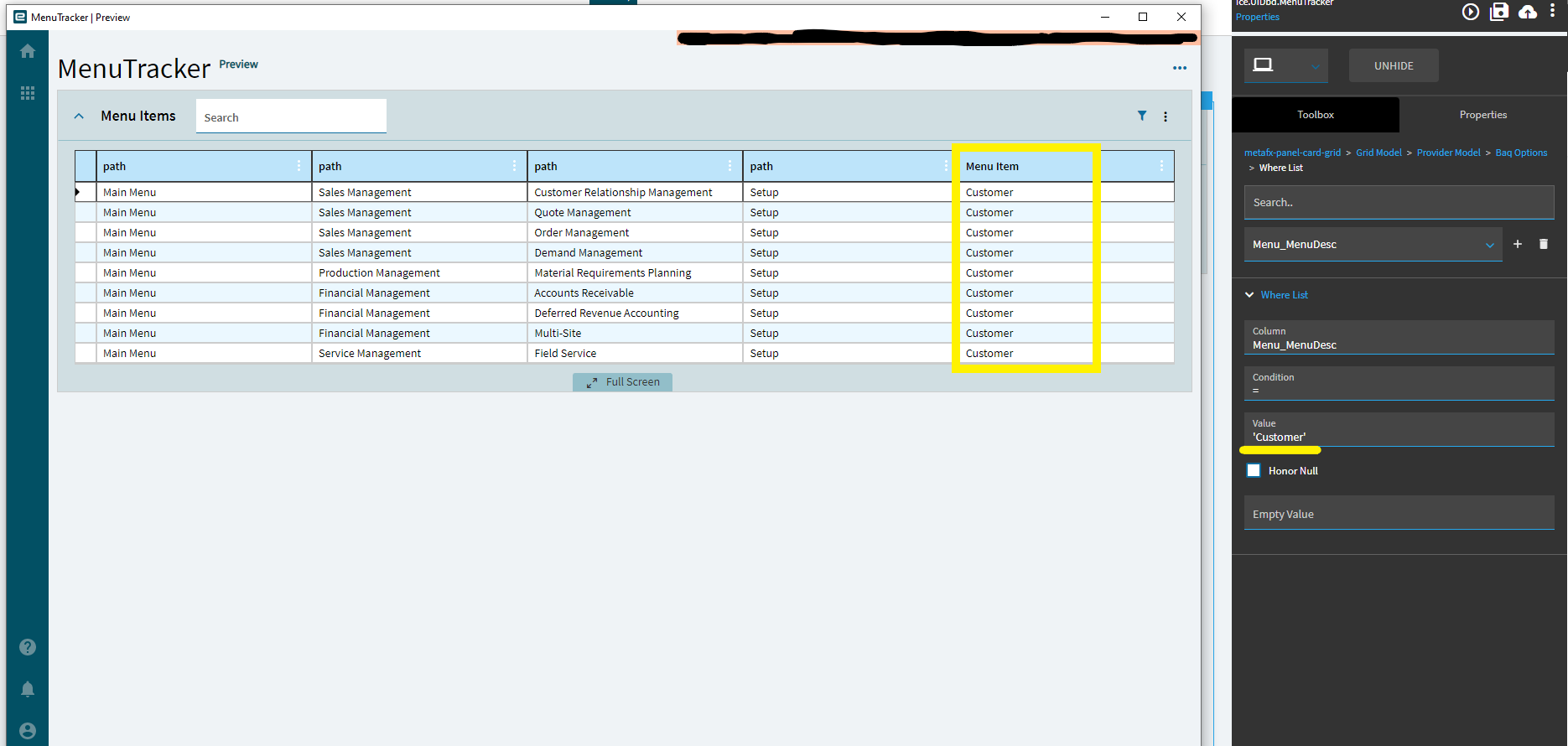

The textbox id is mySearch. I’m trying to grab it’s value to filter the BAQ by putting it in the Where List (using this syntax '${mySearch}'). I know I can filter the BAQ if I hardcode a value, but I can’t seem to grab a dynamic value from my textbox.

textbox id
hardcoded filter
