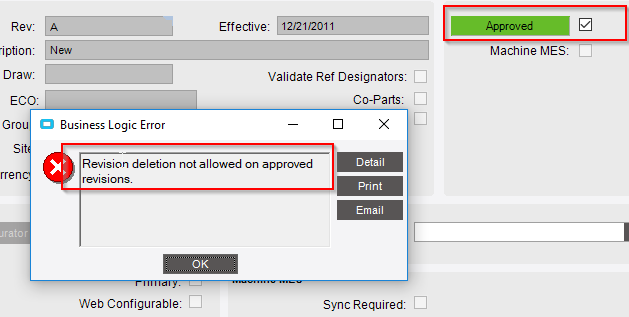

cost transactions, part materials and, and transactions where materials are issued to jobs all contain revisions. Really the only thing that doesn’t is inventory which I’ve always found annoying anyways, but that is what it is. Regardless there should be at the least a confirmation box or configurable flag for it, or if it’s approved to me that should always be a hard stop at the very very least. Anyone that wants it here is what I built for it. I didn’t do so here but it might be worth looking to PartTran for records and just using that vs each specific area, dealers choice.
Part.Update > Pre Processing
Single custom code block
foreach(var tt in ttPartRev.Where(x => x.Deleted()))
  // Check for approved rev
  if(tt.Approved)
    throw new Ice.BLException($"Revision deletion not allowed on approved revisions.");
  // Check usage
  string disallowDelete = "";
  if (Db.QuoteDtl.With(LockHint.NoLock).Where(x => x.Company == this.Session.CompanyID && x.PartNum == tt.PartNum && x.RevisionNum == tt.RevisionNum).Any())
    disallowDelete += $"There are Quote lines containing {tt.PartNum}/{tt.RevisionNum}.\r\n";
  if (Db.JobPart.With(LockHint.NoLock).Where(x => x.Company == this.Session.CompanyID && x.PartNum == tt.PartNum && x.RevisionNum == tt.RevisionNum).Any())
    disallowDelete += $"There are existing Jobs with {tt.PartNum}/{tt.RevisionNum}.\r\n";
  if (Db.JobMtl.With(LockHint.NoLock).Where(x => x.Company == this.Session.CompanyID && x.PartNum == tt.PartNum && x.RevisionNum == tt.RevisionNum).Any())
    disallowDelete += $"{tt.PartNum}/{tt.RevisionNum} is a material for existing jobs.\r\n";
  if (Db.PartMtl.With(LockHint.NoLock).Where(x => x.Company == this.Session.CompanyID && x.PartNum == tt.PartNum && x.RevisionNum == tt.RevisionNum).Any())
    disallowDelete += $"{tt.PartNum}/{tt.RevisionNum} is engineered with ops/mtls.\r\n";
  if (Db.OrderDtl.With(LockHint.NoLock).Where(x => x.Company == this.Session.CompanyID && x.PartNum == tt.PartNum && x.RevisionNum == tt.RevisionNum).Any())
    disallowDelete += $"There are Order lines containing {tt.PartNum}/{tt.RevisionNum}.\r\n";
  if(!string.IsNullOrEmpty(disallowDelete))
    throw new Ice.BLException($"Revision deletion not allowed:\r\n\r\n{disallowDelete}");

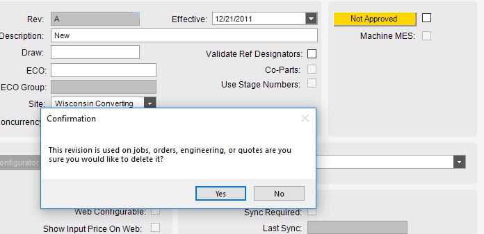

I built a hard stop but if you wanted a soft stop with custom messages asking for specific confirmation you could hook onto the Part.CheckAltMethodForDelete > Post Processing and replace opMessage output with whatever you want and get a confirmation box. When deleting a revision this method is first called the CheckConfigForDelete which is product configuration confirmation then the deletion update happens.
