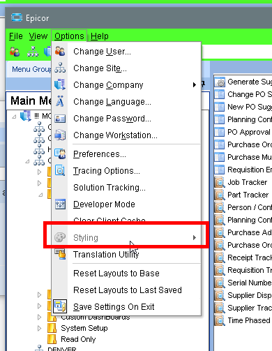

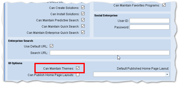

In the User Account Security
Edit
That setting only affects the Styling option on the Options menu:

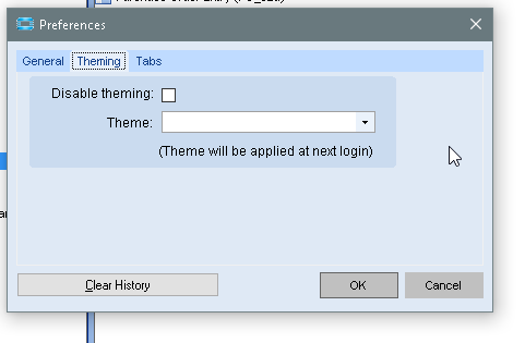

Theme selection should still exist in Options - > Preferences
Note that the configsys file can specify a theme too.
Actually, I think the Configsys file gets updated when the user changes the theme through the UI.
None of this gives my user the Theming tab in preferences…
They don’t see the tab at all? Or is it just that all the controls on it are disabled?
And you are talking about the following window, right?
Correct. They see just General and Tabs. That’s it.

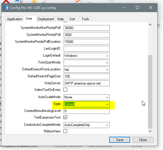

I did log this issue with Epicor Support and the response was to amend the users SysConfig file, they had reports of this logged but seems like they didn’t investigate further due to the sysconfig
file having the ability to control the theme.

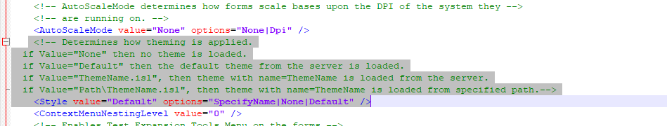

The below element in the client sysconfig file can be edited to control the theme used.
We have made the decision not to change theme now, we don’t want to have to edit this on each users PC.
