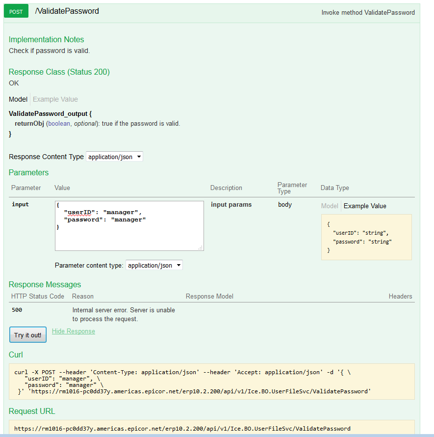

It works in Swagger tester but not the POSTMAN app, but I guess as long as I can use Swagger the postman app is unnecessary.
I’m looking at the help Epicor documentation. Is there a section about authentication to use these REST services?
For instance, on my webpage I’ll have a form and when I click a button I want to take the user inputted userID & Password, and then test it against this service. But how does my webpage have rights to run a lookup against this service since I had to log in to get to see it in the swagger tool?

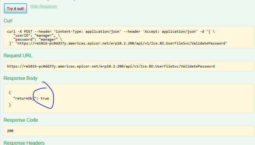

Authentication goes in the header of the REQUEST. To see if the password was correct just make a call to the REST endpoint (any service) I like to use Company or UserFile or BAQ and see if you get a valid response.
If you get 401 that’s a bad uname / password if you get 200 then you are good.

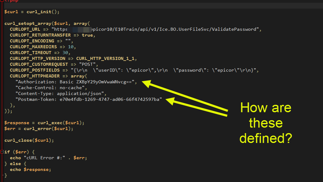

Also in both of your examples it has Postman-Token and Authorization. Don’t those values have to be specific to my script or server?

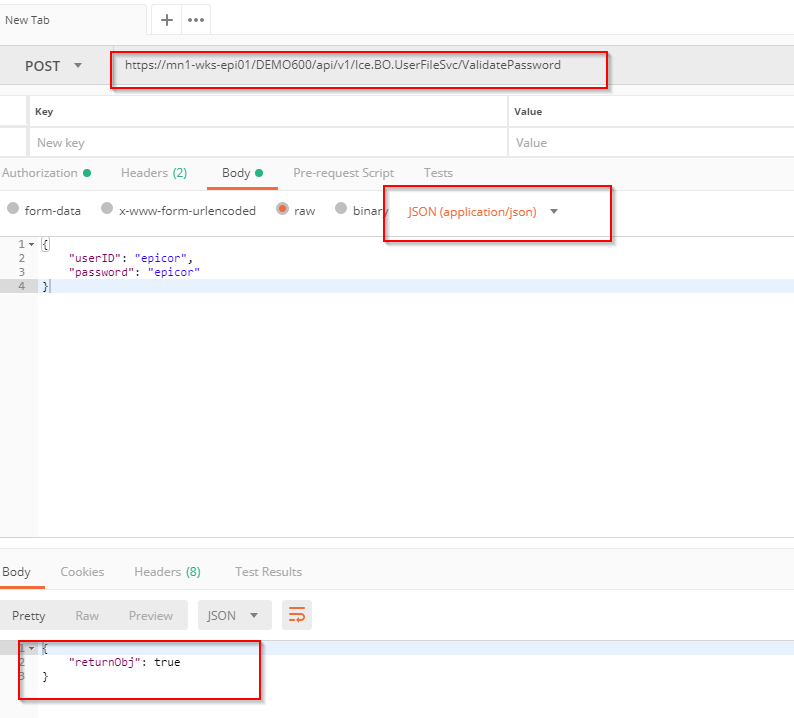

Thank you Dan I was able to get POSTMAN to test it out thanks to your screenshot.

I guess I’m unsure about what the Postman-Token should be or how I would generate that for each request.
Postman token is un-necessary you can erase it. The Auth Basic header is a Basic Authentication header you can read all about it here
But its just a base 64 encoded concatenation of the username and password separated by a colon.
