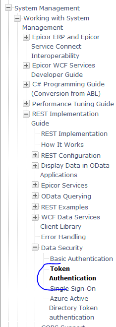

Also take a look at the token service for auth:
Just add the token as a Bearer header and auth done…

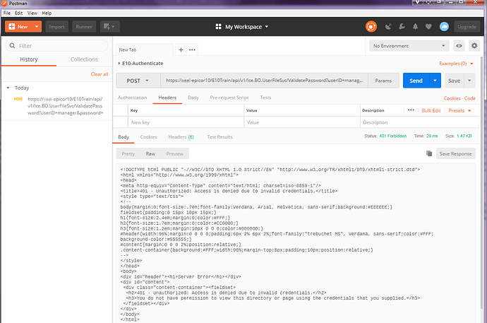

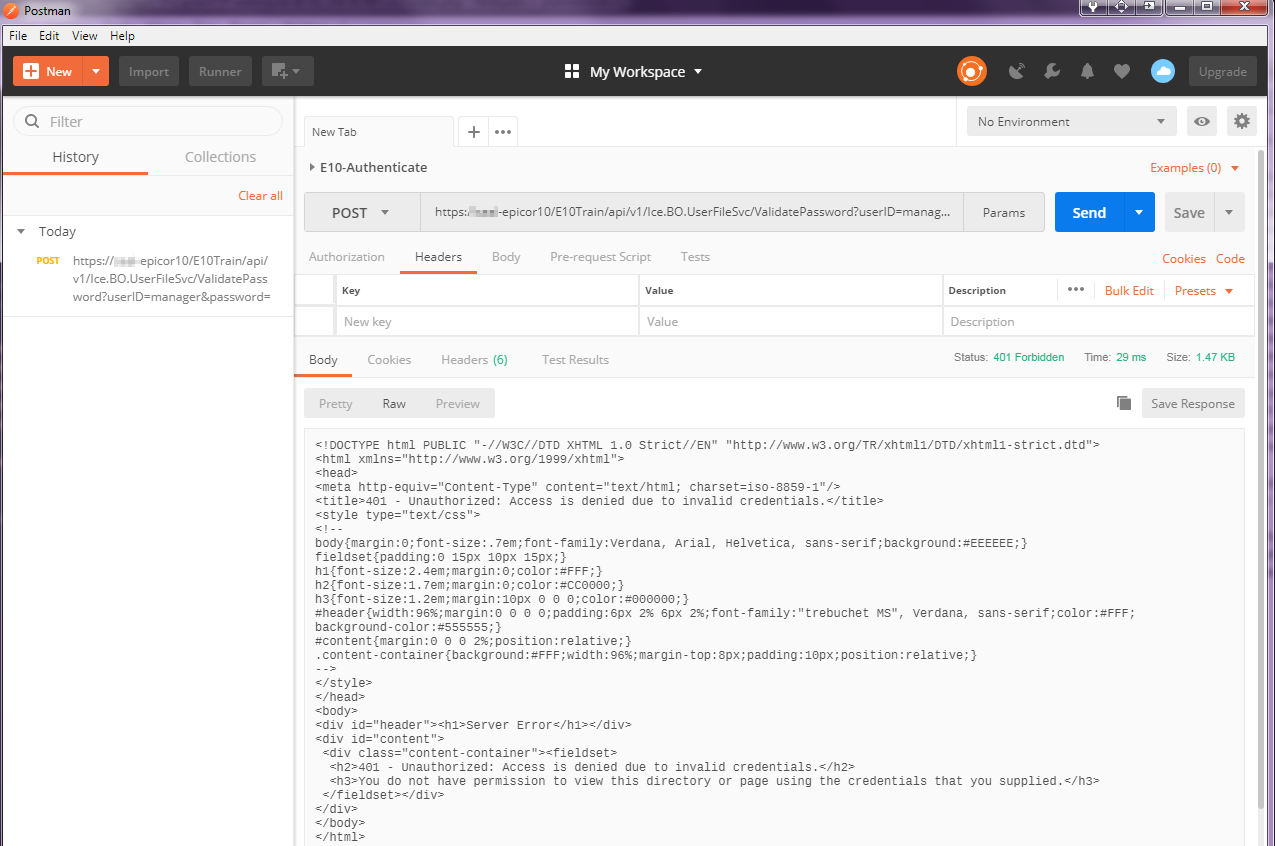

So I tried to connect to the TRAIN database with manager’s credentials and I’m getting an error in POSTMAN (which is a neat little program).
Are there any user settings in Epicor that have to be set so that I can get a valid response?
And yes, the credentials work if I log into the main Epicor application.
What is an access token? How do I get one? Does there need to be a new one each request?
Bearer tokens? JWT Tokens?
ERP 10 has a Token Service to request a jwt token for use as an authentication token. You can set the key and lifespan on the token service in Admin Console.
How to obtain and use one is documented in the REST help:
Simply as to the header of your server calls instead of username / password.
NOTE - Tokens WILL expire. You need to determine how you wish to handle that.
You can determine how long the token lives for (e.g. 24 hours) and set a client timer to obtain a new one at 23 hours.
Or you can prompt for user to log in again when it expires (Think Office 365 / WIndows Accounts - you go into website and are logged in already (their token is in browser cache or similar). If the token expires, the Windows Account login is popped.
In postman just basic auth with name and password should be enougth
Hello Olga,
In postman for this REST service basic auth worked: https://xxx-epicor10/E10Train/api/v1/Erp.BO.SalesOrderSvc/SalesOrders
However for this REST service basic auth does not work: https://xxx-epicor10/E10Train/api/v1/Ice.BO.UserFileSvc/ValidatePassword
Would you know where I can find out how to correctly get the validatepassword service to work?
