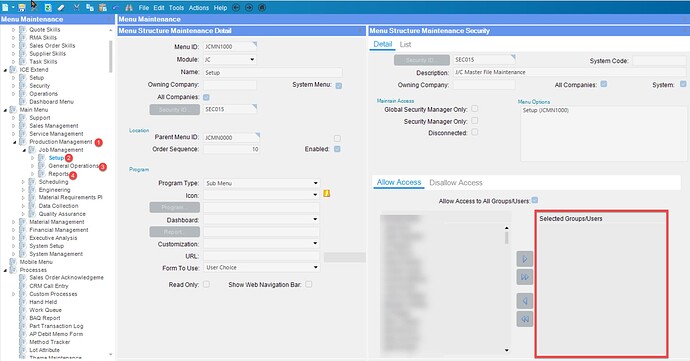

I have setup security at a high level that has worked well.
Three types of users - (A )SuperUser, (B) Manager, and (C) User
Create security groups of
- Order-A !ORder SuperUser
- Order-B !Order Manager
- Order-C !Order User
- Prod-A !Prod SuperUser
- Prod-B !Prod Manager
- Prod-C !Prod User
etc…
Note the ! will put the Security Groups into the top of the Security screen for selection
For each functional area - using the allowed side of the security ID
In the setup area allow - A and B
In the General and Reports allow - A, B, and C
At the processing levels - assign
- A to setup tables - Territories, terms, etc.
- B to Customers, Parts, Suppliers - these are active
- C really shouldn’t need to be assigned at all as they will have access to all processes that aren’t limited.
At the User Level - assign to
- Superusers - Security Groups A, B, and C
- Manager - B and C
- User C
In addition to using security groups - some processes should be changed to read only or taken off the menu.
UOM and UOMClass are processes that should be read only because of the impact of any additions or changes made. A group consensus after testing should be used prior to changes or additions.
Transfer order shipment Entry - if you aren’t multi-site - you don’t need it.
