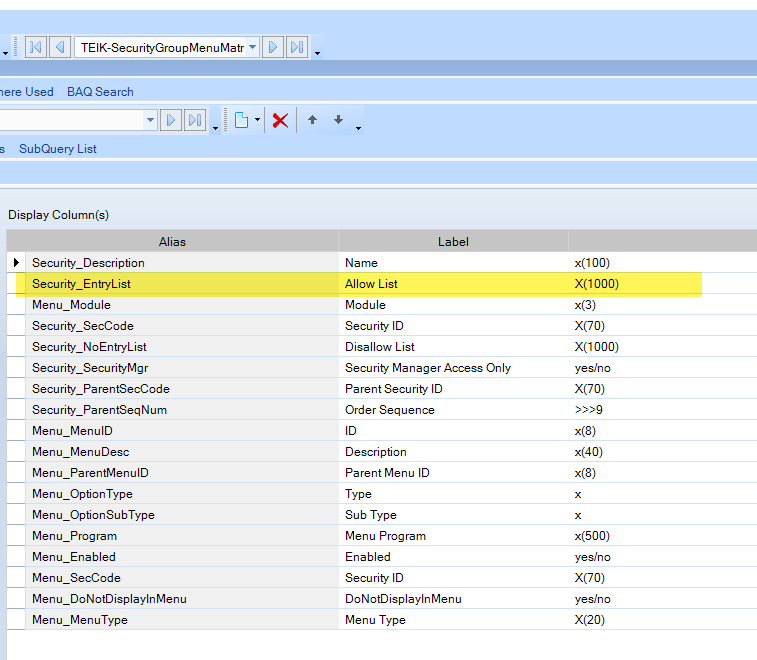

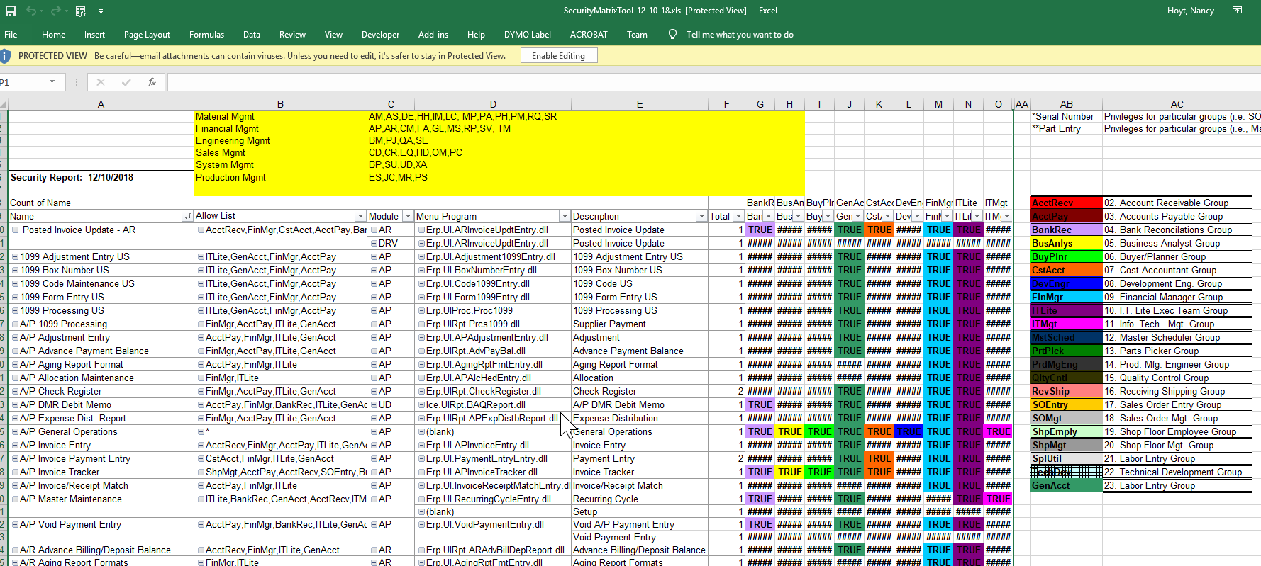

So far the best we have is a BAQ that we download to Excel and do a pivot (colorcoded to note access, see screenshot) and ask managers to review modules that are under their management area. This is the check on whether the security group has appropriate program assignments. After that, we run a list of user assignments to security groups and ask managers to review whether their people are assigned to appropriate security groups and any additional access (e.g. BAQ designer etc.).
We do not use the disallow. We use either allow all or only selected groups. The asterisk in the Allow list in the data is the “allow all”.
If you’d like a copy of the xl workbook w sample data let me know how to email you. It’s not as nasty as it looks. I think the nasty is the sheer number of programs/security assignments really
I was curious could you send me more information on how you created this BAQ? I am able to follow along with the screen shot you provided however I was hoping to see if you could send screen shots of the table criteria and display fields? More specifically i am not finding the allow list field. I went through all the tables and still couldn’t find it.
