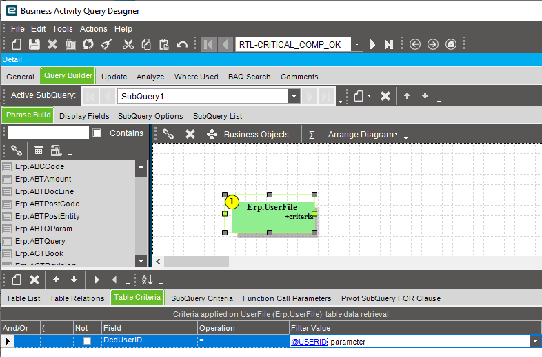

It worked on 10.2.700. We upgraded to 2022.1.23, and now it doesn’t. It returns no rows. If I remove the criteria, it returns all rows as one would expect (so I guess not a new security restriction). If I change the parameter to a constant, it works as expected. If I change the = to <>, it returns all rows including the USERID. It’s like the Parameter part is corrupting the comparison data for this one table only. (We have hundreds of other BAQs against other tables that seem to be working fine.)
I’ve deleted and reconstructed the BAQ from scratch but no change… Anyone have any suggestions?

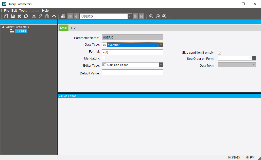

If I change it to the constant ‘%’, it returns all rows, as expected. It really seems like the parameters part is messed up… just in case someone sees something stupid I’m doing:
FWIW sending blank in also returns no rows, not what I’d expect with ‘Skip condition if empty’ set.
