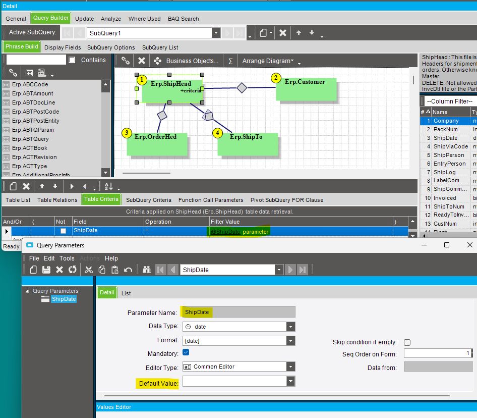

I have an @ShipDate parameter that I would like the default value to be today’s date but I’m not sure how to set that default value.
Thanks for any insight you can provide,
Kelly
They don’t have a dynamic date in that screen, unfortunately. I definitely would be nice though.
So you would have to customize your dashboard to get it to make a default date.
Or (what @CSmith is doing) is make the filter equal to an expression, then use that code, so that if they don’t pass in a parameter, then use today, otherwise use what was passed in.
Like @Banderson said use as expression in a criteria comparison.
Based on your image only other thing you would need to do is uncheck mandatory. I almost always use expressions for everything now to keep from introducing user errors out the gate :slight_smile:

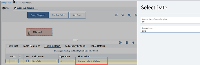

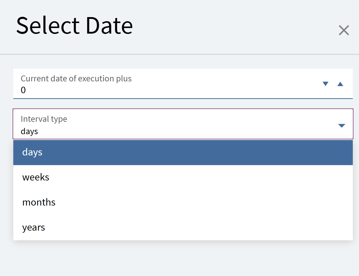

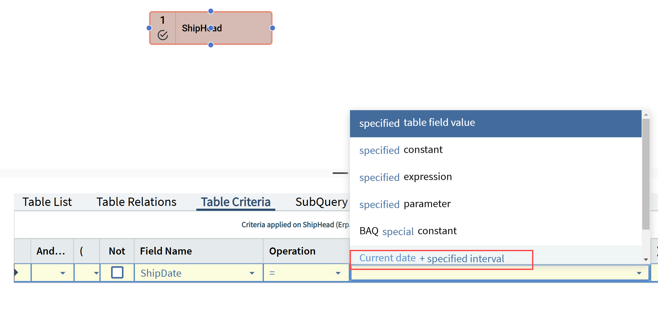

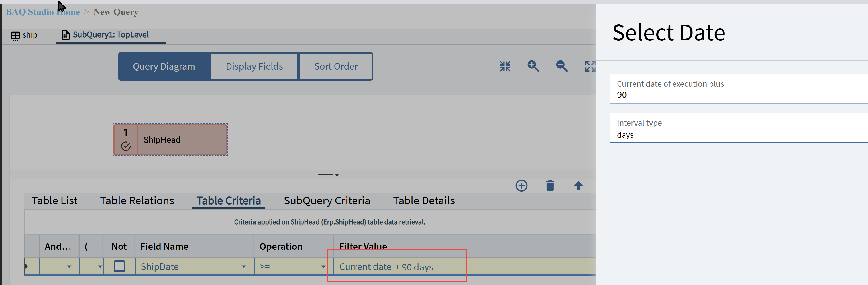

Why not use a BAQ constant which allows you to use days, weeks, months, or years?
The value can be zero days also.
Select Days, Weeks, Months or Years
After you put in 90 days.
