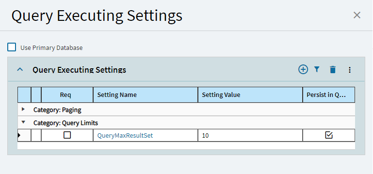

Alternatively, on the Run Query tab there’s a button for execution settings that looks like a gear. you can add a setting for QueryMaxResultSet that will limit your results.
