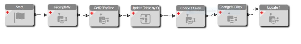

I am working on an updatable BAQ that will change Resource Group IDs for Parts. I already used a ton of help from this group to get this working for the open jobs. Now I am working in the Engineering Workbench, trying to update the master parts. See this related post for reference:
Back to the task at hand. When I try to use the engineering workbench methods CheckECORevApproved, and ChangeECORevApproved, I get an error: “ECORev has not changed.”

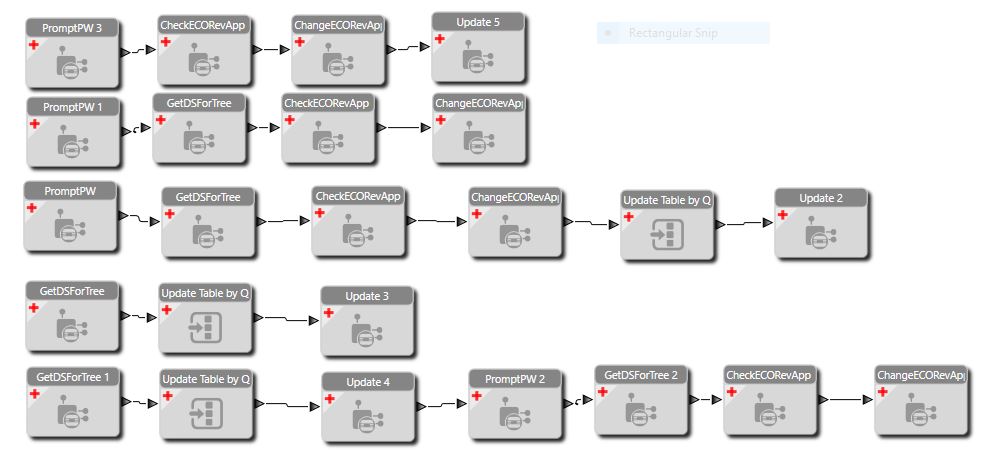

Below I have clipped some of the variations that I have tried.

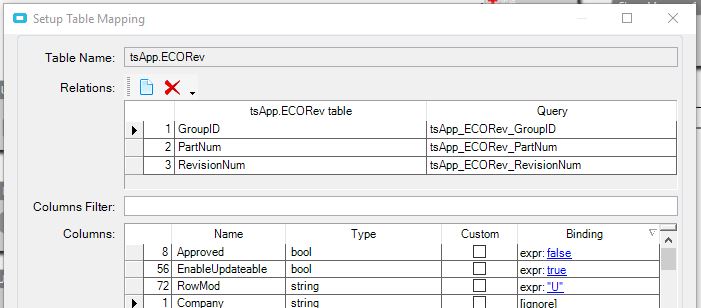

The UpdateTableByQuery does this:

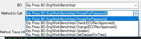

The traces I ran all seem to indicate only these methods:

My goal is to take a part/rev that has been checked out into my temporary group, unapprove the part/rev so that changes can be made, make the requested change*, then reapprove the part and check it back in.
*I will be changing the ResourceGroupID for specific operations in the selected part/rev.

As a very general idea, when you are modding those records, are you also setting RowMod = “U”?
Yes, in the examples when I include the UpdateTableByQuery widget, the RowMod = “U” is part of it. The problem is that the execution never gets that far. Anytime I have a Check- or Change- ECORevApproved, I get the error.
In at least one case I put the updatetablebyquery widget before the problem methods. This didn’t help. The query worked by updating the values in the dataset, but updating the DS does not execute the check/change methods, so I really need to run those methods somehow.
Is there anyplace that details how to implement specific BO methods? I can’t find any way that those methods do not return an error. I am sure there is some underlying field that needs to be changed or something before I can execute those methods.
