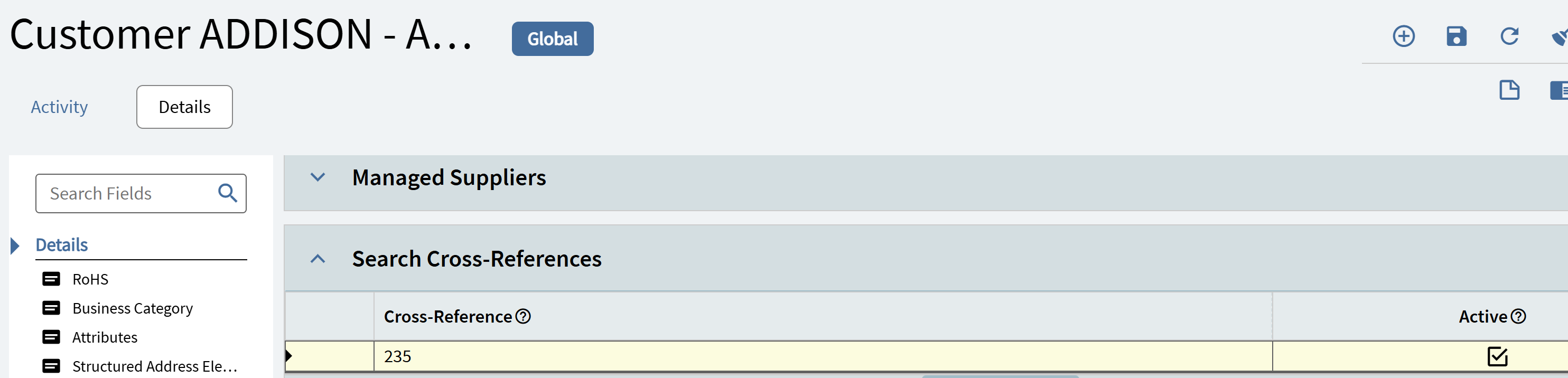

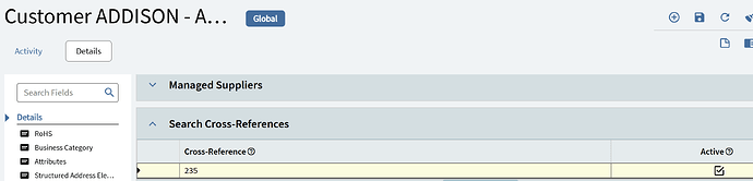

Using standard functionality - you can use Cross-Reference

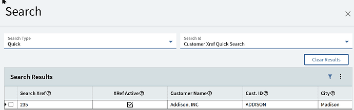

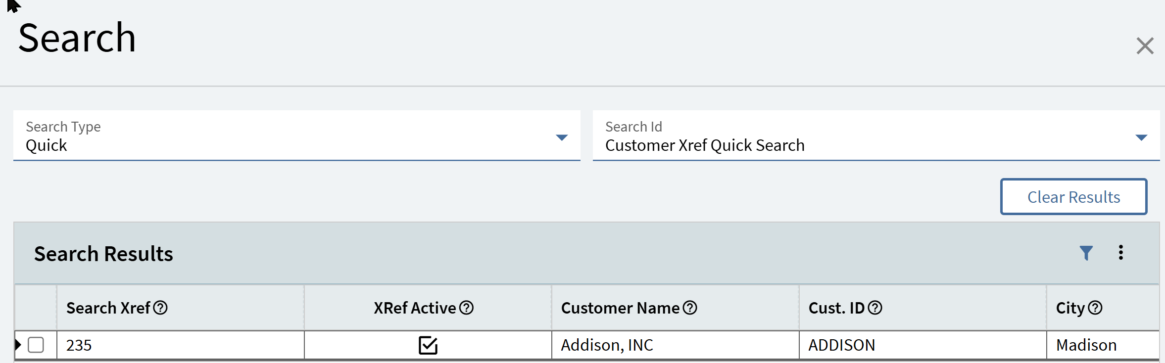

You can also create a Predictive Search that will pull up the customer by just typing in the cross-reference.
Going further, you can create a predictive search with the customer name
