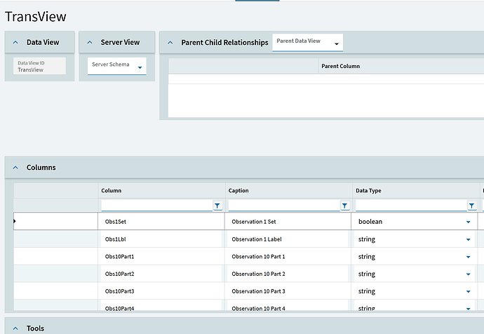

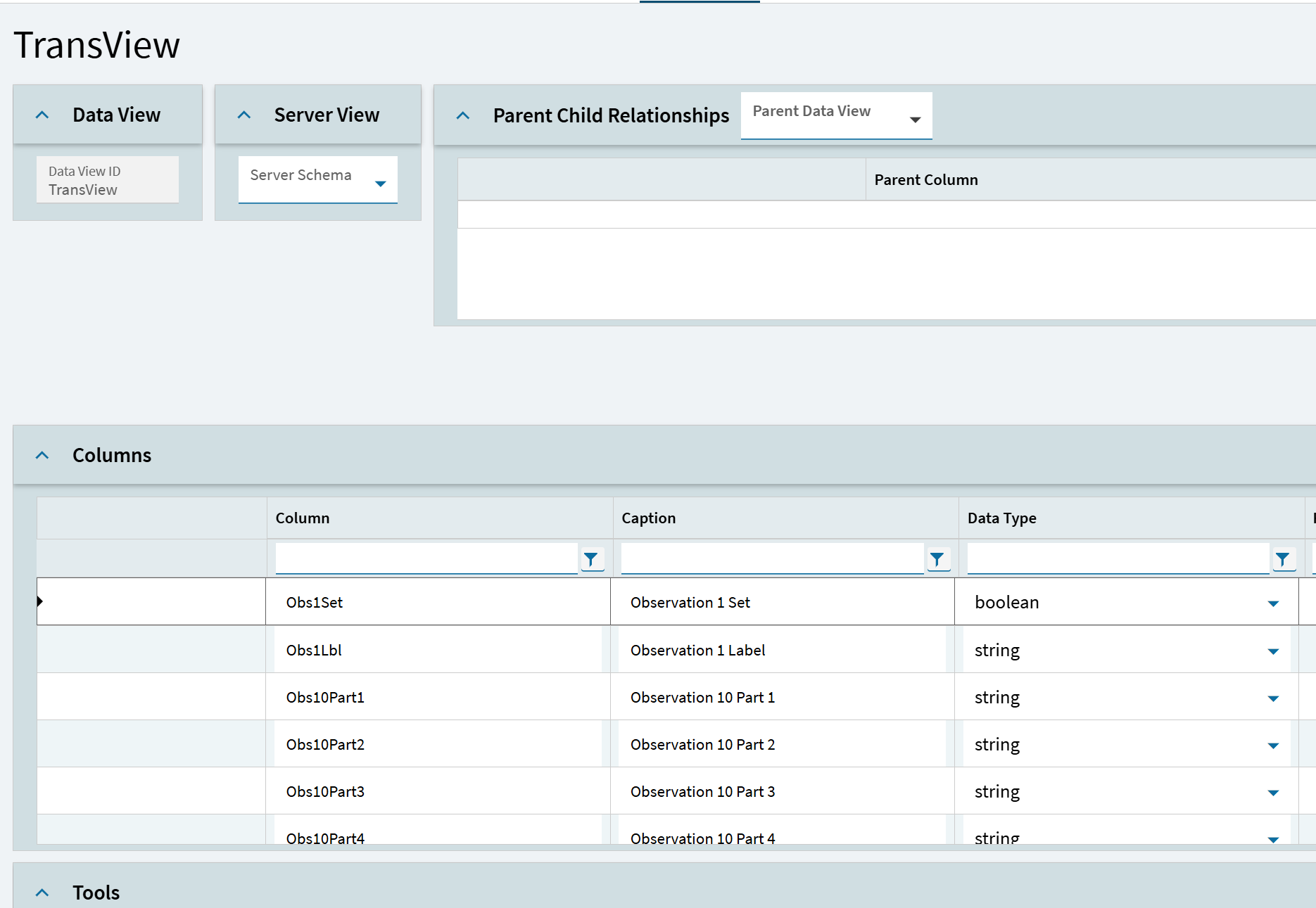

Thanks, I have defined the columns in the TransView dataview, like so;
I’m not initialising my transview (rookie error) via a row-add when the app loads. So could that be the issue?

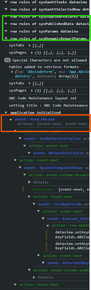

Part of the issue may be that row rules are evaluated BEFORE even Form_onLoad or other following events even come into play:
So, the row rule may always fail because TransView hasn’t even been initialized yet. There’s nothing there to evaluate.

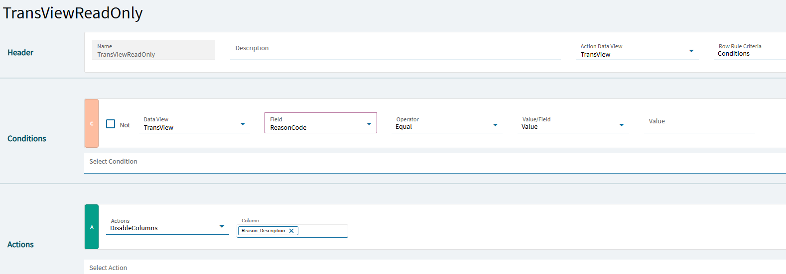

First row-update
Second row-update
When your TransView column changes… the Row Rule will be re-evaluated.
Results:
Row Rule successfully disabled my TransView.Reason_Description column
