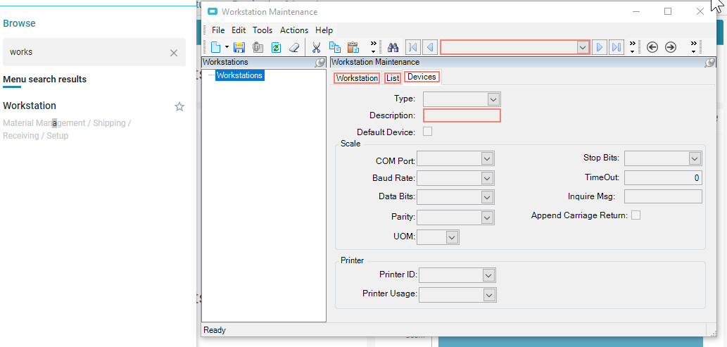

Hey there, sorry to bring this up again, but Is the printer settings set up in the Workstation menu? It looks like this is for shipping, but is this where i should be configuring this?
Search for Printer Maintenance…
