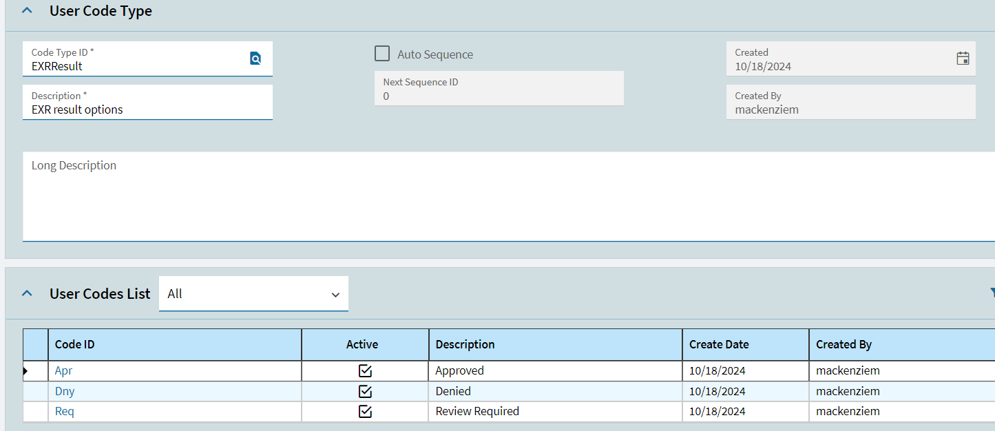

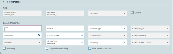

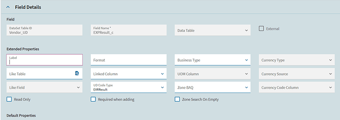

I am trying to create 2 separate combo boxes on the Vendor/Supplier screen that are populated from 2 different User Codes. I created the 2 User Codes and I have UD columns created and mapped correctly. The issue I am running into is when I try to set the combo box Type to UserCodes.UserCodesCombo and set sub type to default, it autopopulates everything and when I try setting the filter param to {CodeTypeParam}=VendSelect (the other is {CodeTypeParam}=EXRResult) it actually combines both User Codes into both combo boxes. I also went into Extended Properties and set the UD Code Type to the correct User Codes.
Am I missing something?

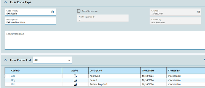

EXRResult User Code

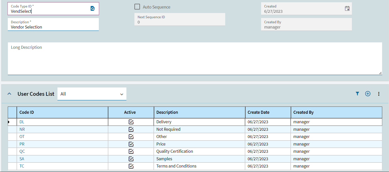

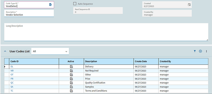

VendSelect User Code

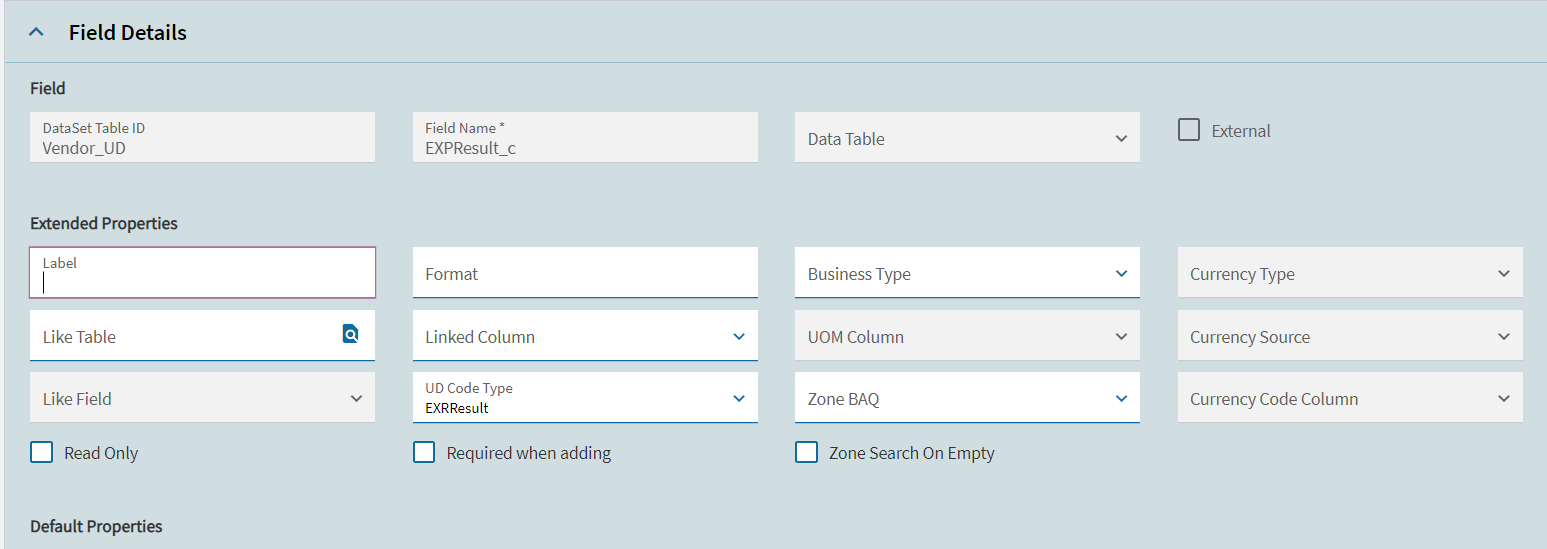

Extended Properties EXPResult_c

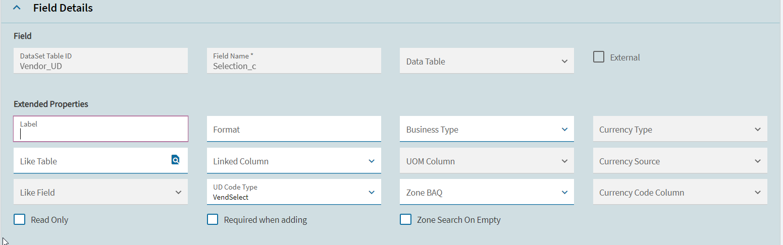

Extended Properties Selection_c

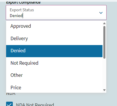

Results
This is the EXPResult_c combo box
It should only have Approved, Denied, and Review Required.
The other combo box displays the same list.

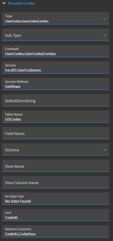

You don’t HAVE to use “default” here. You can leave it blank and fill in the properties you need. So, take screen shots of the “default” settings… but then go back and remove “default” and fill them back in the way you want/need them.
Below is one of my “custom” UDCode Combos… For example, the “Retrieve Columns” defaults to CodeDesc. But what if you want different, or more columns returned. Well, you have to NOT use the “default” and build the combo settings manually. Then I can set my “Retrieve Columns” to CodeID,CodeDesc (and get both of them pulled back).

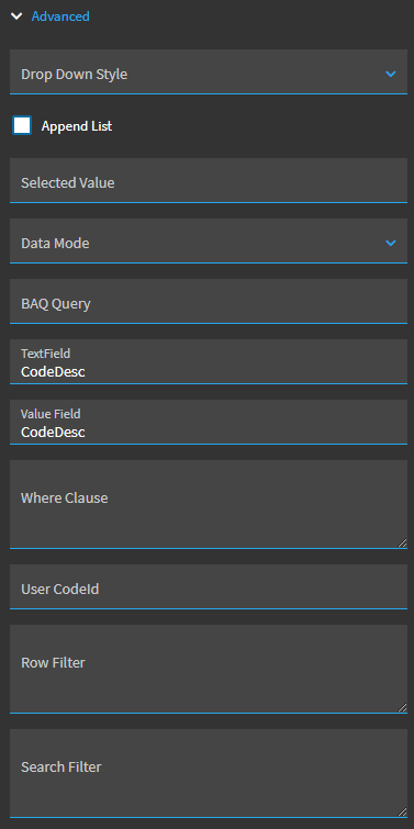

I just poked at this… I was able to get IsActive = true to work in Row Filter (under Advanced):
It’ll still return all row in the call, but it then filters our the IsActive = false records.

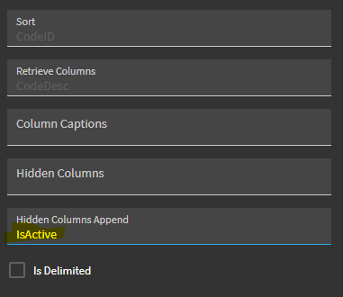

The key here is that I also had to add IsActive in the Hidden Columns Append setting:
Without that, the call still worked but it wouldn’t display anything in my dropdown.
