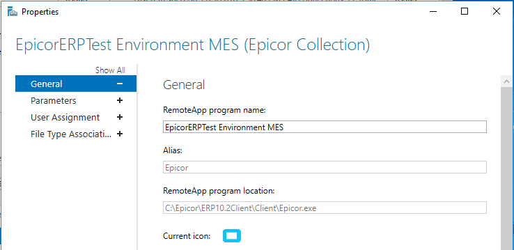

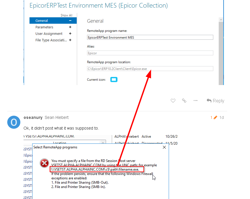

We are using an Android tablet for our material handlers. We want to use Remote Desktop for the Remote App. We shared the software but we receive an error:
Could not find file:
C;\Epicor\erp10.2client\config\default.sysconfig

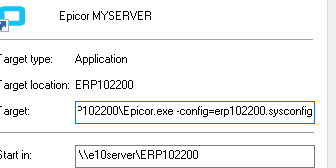

We need the path to point to our on-prem:
C:\Epicor\ERP10.2Client\Client\Epicor.exe /config=EpicorERPTest.sysconfig

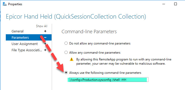

Our IT department has been utilizing “Work Resources” with our E10 software and its been extremely helpful when its come to upgrades as our Group Policy handles all of the permissions as to which users get shortcuts for certain apps of E10.
Could you provide a short outline of how you setup your work resources? I can see if I can rope in our main guy regarding our setup to help out.

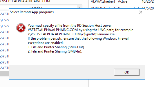

Here’s what I’ve done so far. I created the RD Server, and have published Epicor as a software for RemoteApp. I installed Remote Desktop app on the tablet, and confirm that it appears on the Apps tab for the Remote Desktop app. I was looking at the instructions on changing the program target, but I neglected to add that we are using WinServ 2016. The instructions were for 2008, and I’m unable to make the changes anyway.
