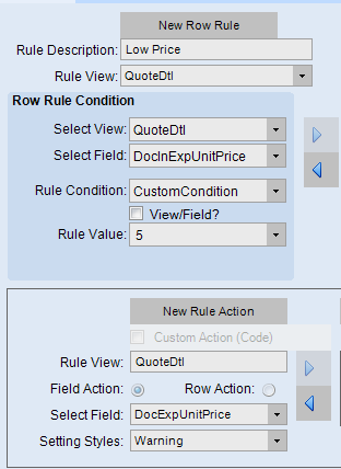

I am attempting to create a row rule using a custom condition. In the wizard it looks like this;
I put 5 in the rule value because that is what was done in the Customization User Guide
This is the auto generated code with my condition added. I eventually want to compare with 2 UD fields, ie; greater than UD field 1 and less than UD field 2, but as I can not even get past the first hurdle I have hard coded values instead.
