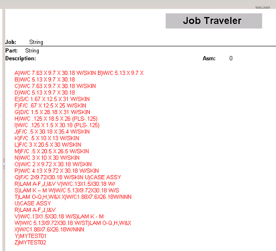

I tried both and neither made a difference.
=Code.GetItem(Fields!Description.Value, “JobHead”,24)
=Code.GetItem(Fields!Description.Value,24)
Error:
The Value expression for the text box ‘Textbox26’ refers directly to the field ‘Description’ without specifying a dataset aggregate. When the report contains multiple datasets, field references outside of a data region must be contained within aggregate functions which specify a dataset scope.

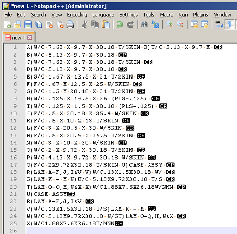

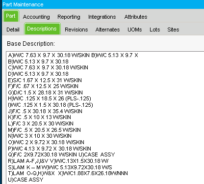

I’m looking at your example string, now I’m wondering how they were origianlly generated?
and just wanted to make sure a string should look like this if opened in NotePad++ ?
and description(s) in part entry looks like this?
chr(13) instead of char(13)?
Correct. Too many languages in my head… Fixed.
=iif(IsNothing(Fields!Description.Value),"",Replace(Fields!Description.Value,VbCr,VbCrLf))
And the formula above seems to work for a quick test… assuming my string actually matches what is going on?

I have something that seems to work.
Public Function ConvertToTable(ByVal s as String,itm as integer) as String
Try
Dim sa() as string
sa = split(s, chr(13))
Return sa(itm)
Catch
End Try
End Function
Expression:
=Code.ConvertToTable(First(Fields!Description.Value, “JobHead”),24)
With each field with the itm number I want to show.

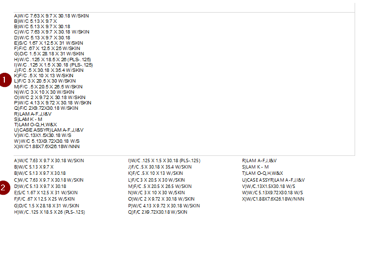

Here’s one way make multiple coulmns in SSRS…
I forgot to add without a tablix but this is the way to do columns. It is clever and versatile.
If the original goal is just to make a long narrow string appear as multiple columns - and that you don’t need the individual elements - just break it into 3rds.
The first row of this is the original data (one long string with CR’s embedded in it)
The second row is a rectangle with three text boxes in it (TextboxCol1, TextboxCol2, and TextboxCol3).
The expression for each textbox is:
TextboxCol1
=Left(Variables!st.Value, InStr(Variables!st.Value,Variables!st.Value.Split(vbCrLf)(Ceiling(Variables!st.Value.Split(vbCrLf).Length/3))))
TextboxCol2
=Mid(Variables!st.Value, InStr(Variables!st.Value,Variables!st.Value.Split(vbCrLf)(Ceiling(Variables!st.Value.Split(vbCrLf).Length/3)))+1, InStr(Variables!st.Value,Variables!st.Value.Split(vbCrLf)(Ceiling(Variables!st.Value.Split(vbCrLf).Length/3*2))) -InStr(Variables!st.Value,Variables!st.Value.Split(vbCrLf)(Ceiling(Variables!st.Value.Split(vbCrLf).Length/3)))
TextboxCol3
=Mid(Variables!st.Value, InStr(Variables!st.Value,Variables!st.Value.Split(vbCrLf)(Ceiling(Variables!st.Value.Split(vbCrLf).Length/3*2)))+1,
Len(Variables!st.Value)
One short fall of this, it hiccups on duplicated rows.
Probably cleaner to make functions in the Report Code and call them.
And MUCH cleaner as a a Report function. You’d use the same call in each columns expression. Just modify the colNum parameter.
=Code.ColText(Variables!st.Value, vbCrLf, 1, 3)
