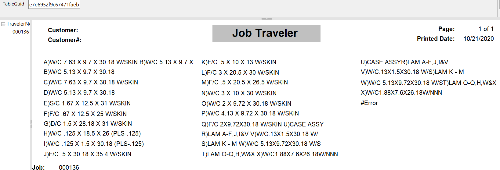

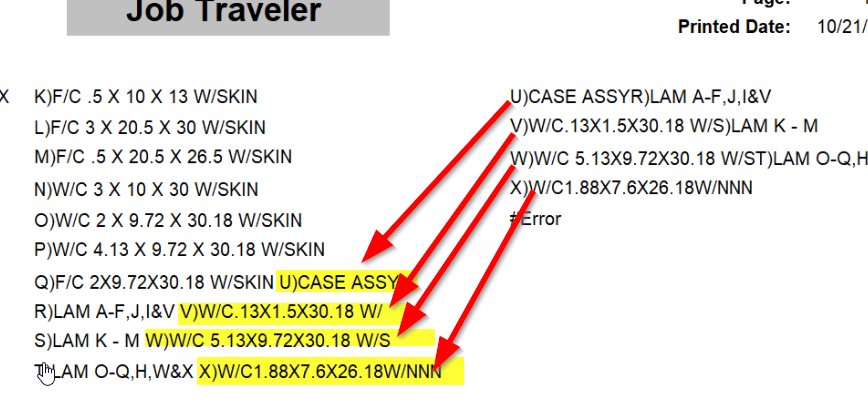

The field data below has separated returns of chr(13) I can split each and put them in specific fields on the report until I hit one missing in the index value then everything I’ve tried will return an error.
A)W/C 7.63 X 9.7 X 30.18 W/SKIN B)W/C 5.13 X 9.7 X B)W/C 5.13 X 9.7 X 30.18 C)W/C 7.63 X 9.7 X 30.18 W/SKIN D)W/C 5.13 X 9.7 X 30.18 E)S/C 1.67 X 12.5 X 31 W/SKIN F)F/C .67 X 12.5 X 25 W/SKIN G)D/C 1.5 X 28.18 X 31 W/SKIN H)W/C .125 X 18.5 X 26 (PLS-.125) I)W/C .125 X 1.5 X 30.18 (PLS-.125) J)F/C .5 X 30.18 X 35.4 W/SKIN K)F/C .5 X 10 X 13 W/SKIN L)F/C 3 X 20.5 X 30 W/SKIN M)F/C .5 X 20.5 X 26.5 W/SKIN N)W/C 3 X 10 X 30 W/SKIN O)W/C 2 X 9.72 X 30.18 W/SKIN P)W/C 4.13 X 9.72 X 30.18 W/SKIN Q)F/C 2X9.72X30.18 W/SKIN U)CASE ASSY R)LAM A-F,J,I&V V)W/C.13X1.5X30.18 W/ S)LAM K - M W)W/C 5.13X9.72X30.18 W/S T)LAM O-Q,H,W&X X)W/C1.88X7.6X26.18W/NNN U)CASE ASSYR)LAM A-F,J,I&V V)W/C.13X1.5X30.18 W/S)LAM K - M W)W/C 5.13X9.72X30.18 W/ST)LAM O-Q,H,W&X X)W/C1.88X7.6X26.18W/NNN

the problem is each record changes it the number of elements. may be one to 78. as soon as the number doesn’t exist there is an error. I’ve even tried a IIF it is over a number to put “” and it still evaluates if it contains the index and errors. I haven’t found a way to ignore the error.
=IIF(
First(Fields!Description.Value, “JobHead”).Split(chr(13)).Length < 24,Microsoft.VisualBasic.Strings.Split(First(Fields!Description.Value, “JobHead”), Microsoft.VisualBasic.Strings.chr(13)).GetValue(24),
You can see the last one is error.

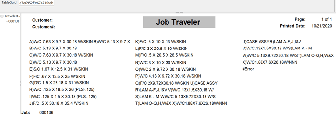

This is the expression for A and it works.
=Microsoft.VisualBasic.Strings.Split(First(Fields!Description.Value, “JobHead”), Microsoft.VisualBasic.Strings.chr(13)).GetValue(0)
If I try 24 thru 78 that doesn’t exist with this record it errors.
I tried your code and still got the error. Because 24 doesn’t exist even if the IIF is True or false.
Are you sure you’re getting the Split that you think? I’m only guessing at what your data is supposed to be, but the following looks like it failed to split some “records”

First attempt to run.
