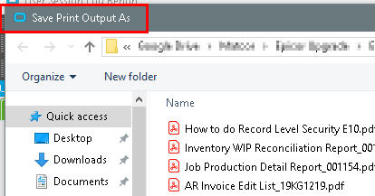

If you opt to email a report (instead of printing or previewing it), the email sends just fine, but then a “Save as” dialog appear.
This happens for emailed reports that are scheduled too. The email goes out at the scheduled time. The next time I launch the client, the Save As dialog appears.
It’s definitely from the client program, as the save as window has the Epicor logo
And selecting cancel in the Save As window yields
Even though the email did go through.
