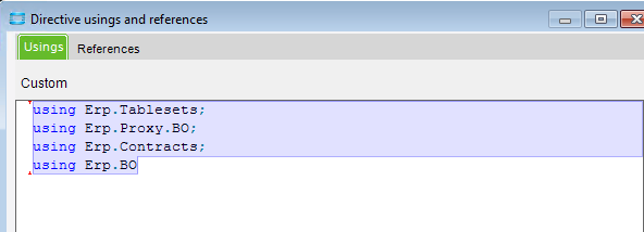

I have tried a bunch of different usings and references and changing it to stuff like JobEntry.GetDatasetForTree() but it never recognizes the method.

Make sure to add the appropriate reference as well.

I can see that var jeSvc = Ice.Assemblies.ServiceRenderer.GetService(Db); is going to fix the null reference exception but Db it still can’t find the type or namespace. Althought the Epicor editor highlights it purple so it recognizes it in some way. I have all the using statements and references you put.
