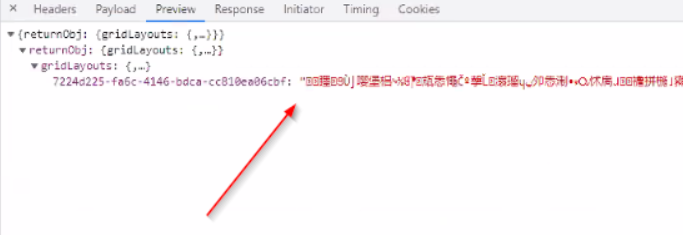

@josecgomez and I were wondering why Kinetic Grid Layouts Speak Chinese.

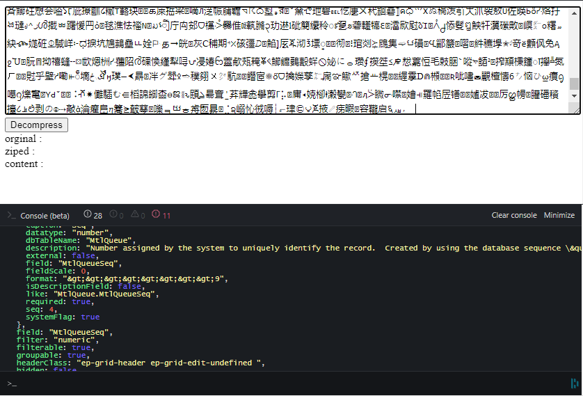

Turns out it is just UTF-16 compressed with a javascript library called zlib. If you want to view the contents of the layout and possibly make some changes and then invoke the Ice.BO.KineticErpSvc/ SaveGridLayout method yourself. We slapped together a quick jsfiddle.
It will also output the JSON to the console for easier reading.
(SAFE HARBOR, I quickly made this without having any coffee in me).
Fiddle Link
