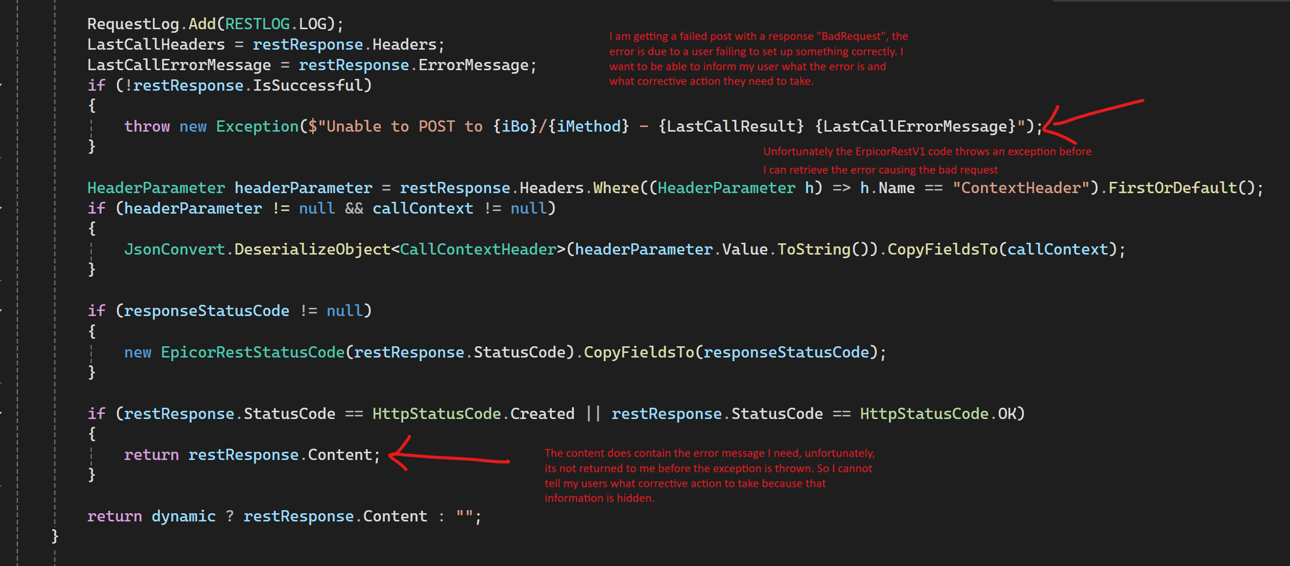

Unfortunately, if the request responds with a “BadRequest” Http Status, the EpicorRestV1.DynamicPost(“”) library will throw an exception. This prevents me from actually seeing the error in the response body. In my case, my Bad Requests are a result of misconfigured products. It would be useful to be able to inform our Epicor users that a product needs some corrections, but unfortunately, because the exception is thrown before the response content is returned, I can’t actually know for certain what the error is.

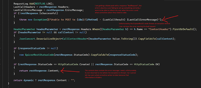

I am (attempting to) attach a screenshot of the EpicorRestV1 PostJSON code to show where it returns the error
I am wondering if there is a work around that will allow me to see the error in the response instead of throwing the exception.
This use to work before the upgrade… so we’re wondering if there’s a difference with how the core variant of the library bubbles up the error.
