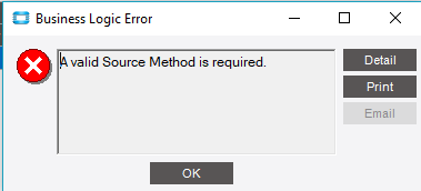

While trying to copy a MOM from a method, the following error message displays. What am I missing?
error message
If you click the Detail button on the error… are there any other clues listed?
Business Layer Exception
A valid Source Method is required.
Error Detail
Description: A valid Source Method is required.
Program: Erp.Services.BO.QuoteAsm.dll
Method: GetDetails
Line Number: 18173
Column Number: 33
Table: PartRev
Field: Method

Do you have an inactivated resource on the source MOM?
If trying to get details from a job… is the source job marked as a template first in job maintenance?
If you have multiple sites, is your parent part Rev site setup as same Rev site you are pulling details from?
