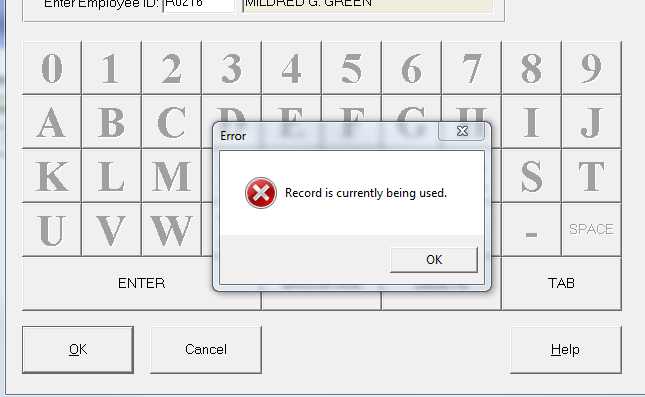

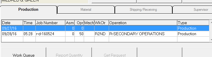

This is the first time this has happened to me. I have an employee that is stuck in an open record in the Plant Floor module. This employee does not have a Vantage ID.
How can I clear this out?
not sure if it is the same in 8 as it is in 9 - there are a conversion
programs for this. 8920 for labordtl and 8930 for labored. I think those
will fix this (haven’t had this issue in quite a while)
There are two programs / conversions that need to be run to fix orphaned records like this. ENDACT.r and CLOCKOUT.r. You can get these from support or if you are on 6.10.535 or above I believe they should be in your Utilities\Database conversions folder.
I have an End Activity for Labor Detail and End Activity for Labor Header. Those did it.
