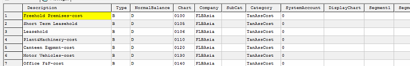

I wonder if anyone can tell me - pop quiz style, what GLChart and GLDept tables in the old Vantage 8 Schema have been replaced with, or evolved into in Epicor 10 . Although I suspect, there wont be one single easy answer…
The GL Accounts that sat on the list view in Product Group, Part, Part Class, Company Config, Supplier, Bank etc have all been replaced by GL Control Codes starting in Epicor 9 and carried through to Epicor 10
