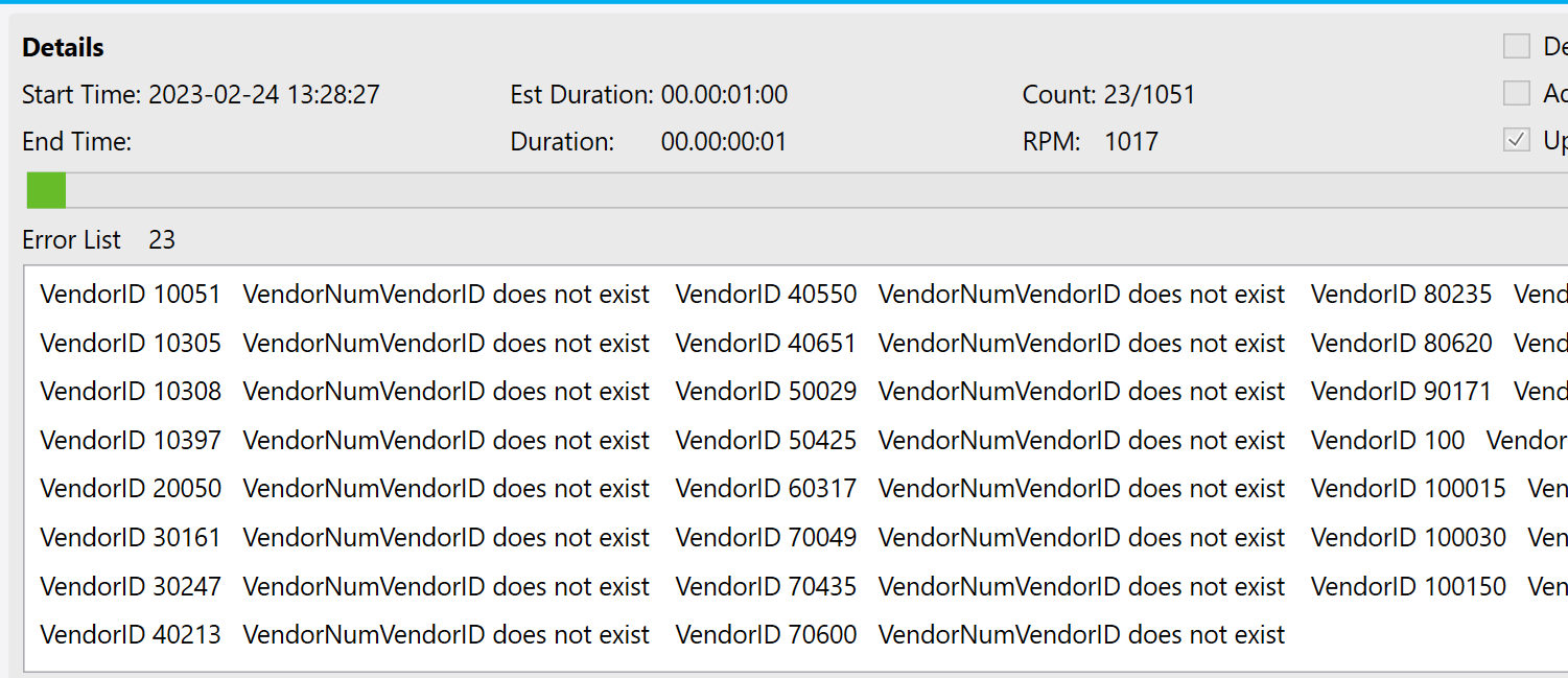

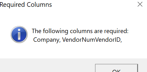

I’m trying to use DMT to update a UDF in the VendCnt table.
I see the required fields and have them in my dataset.
I’ve tried it with just those fields and it failed. I added ConNum and it also failed. I added VendorNum and it failed.

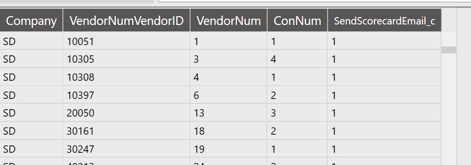

Here’s what the latest data set looks like I’m trying with:
Has anyone successfully used DMT to update a UDF on a vendor contact? Something that should be easy is becoming a big headache.

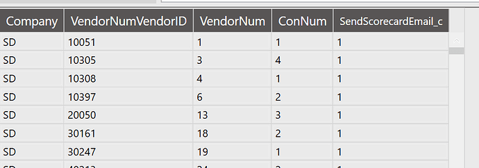

I think I solved it by adding a couple more columns.
Name and PerConID to the DMT file.

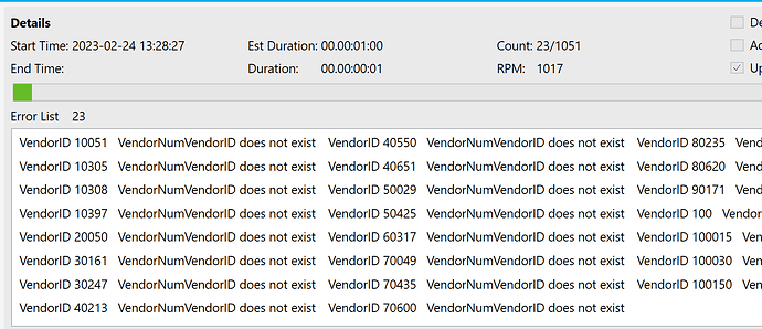

Now it’s running and updating. Still a couple it can’t find but the majority are running through.
I chalk this up to another example of the Epicor documentation needing to be updated.
