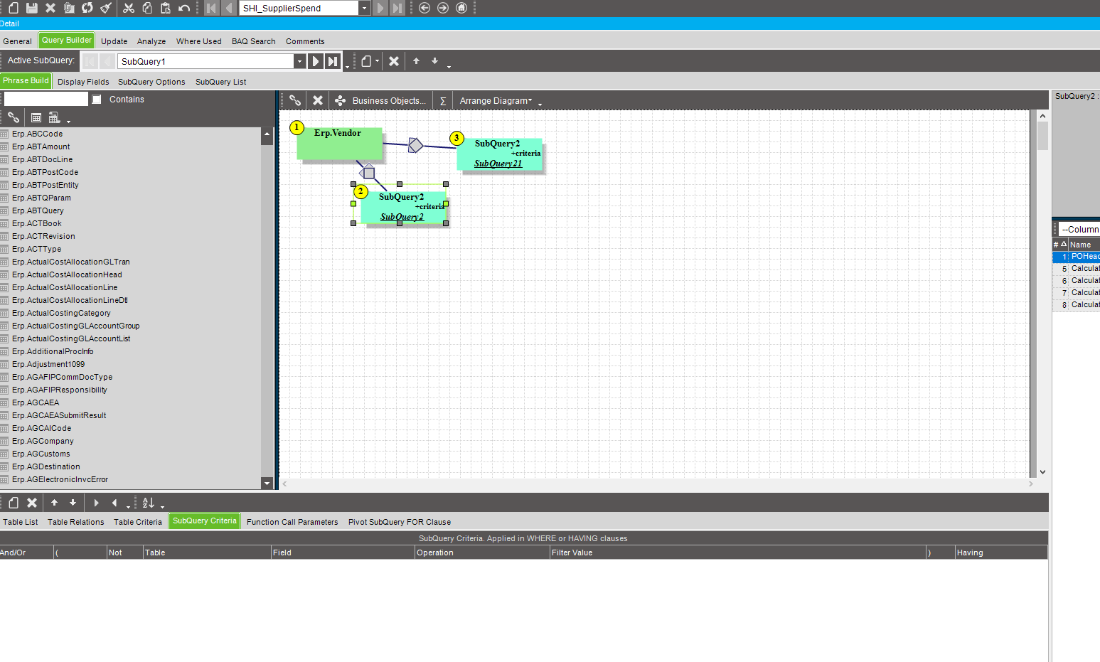

The current BAQ is not pulling the correct numbers. When we pull the data from the supplier tracker (links) it shows different summations; by a huge margin on both sides.
That was added by you or someone to filter the returned records. Are you looking to only see the last year’s values? If so, I would put that filter in the sub query. Also, you don’t need two sub queries for this, just a CASE statement for one year vs another.
This was not created by me. I was tasked with fixing it, however. I believe they want the current year, not last year. I am not sure how to edit the SubQuery, as nothing comes up under that tab:
Period to Period, our Received not invoiced is not an issue. The goal is to capture invoiced dollars either associated with matched purchase orders or misc invoice dollars. The exercise is how much do we owe a supplier/vendor according to their invoicing… Sum by supplier invoice date is fine.

You cannot paste script into the BAQ designer - you have to design from scratch - attached is an AP Spend by Supplier BAQ that hopefully will help. This BAQ looks at AP invoices rather than PO’s as the PO could be raised for a different value than the final supplier invoice
