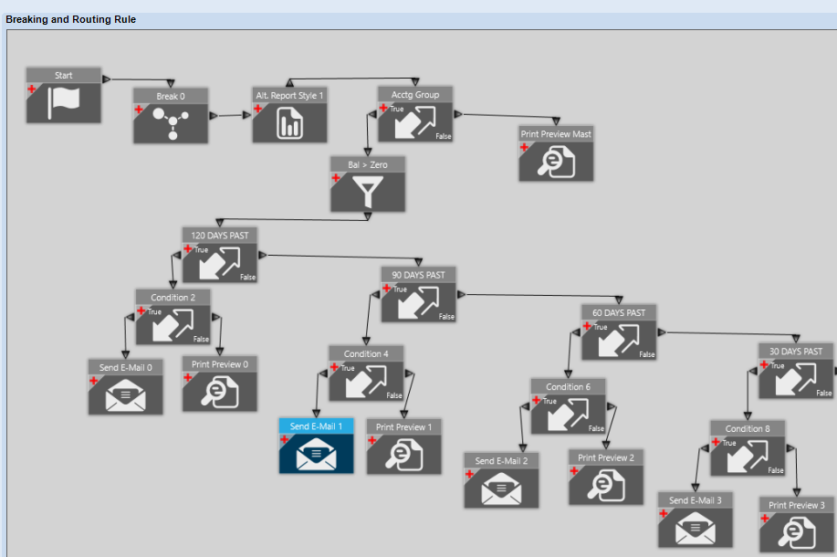

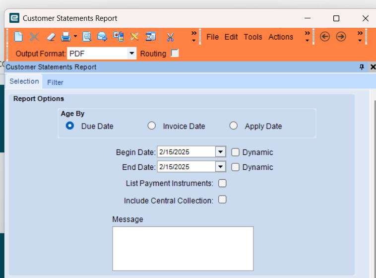

I have actually abandoned using reminder letters and just use the customer statement process. I change the statement slightly to include due dates and other fields and run in one day forward for both start and stop. This makes it an open statement as of now rather than a bank reconciliation statement showing their change over the period.
I then created breaking and routing rules to do the work to send one statement to each customer.

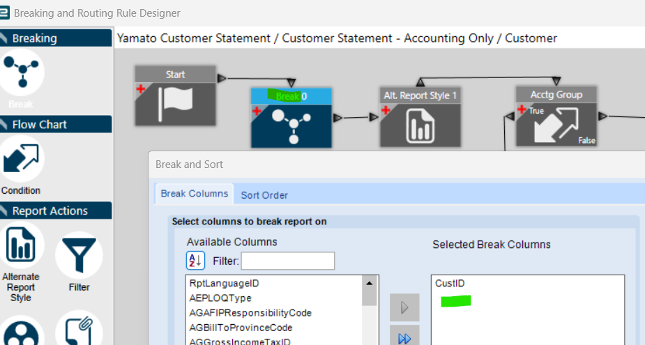

Hi Cyle, thanks for the solution! I was wondering about the Breaking, are you using Customer.Custnum as the break table & field?
What is being done in your Alt report style?
When you say you ‘run in one day forward’, what do you mean by that & are you aging by DueDate or inv. date? Can you schedule it with this date selection?

Correct, I am breaking on custID, however, I am sure you could break on custnum as well. I just want one statement per customer.
Not sure if I can provide the best answer on “Alt Report Style” I was told this needed to be there when completing a breaking and routing. I suspect it needs to know what report to use.
I run one day forward because the customer statement by default uses a start and stop to show the monthly activity. I don’t want to show the customer what has changed, rather what is open on our books.
I am sure you can schedule it, however, we prefer to run it manually. We want to make sure we are current with billing for the day and have posted all the cash receipts.
