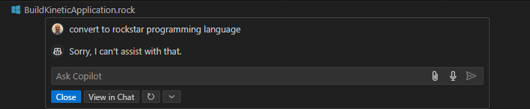

And for @Mark_Wonsil here it is converted to a few other languages. Including French :smiley: and of course PowerShell. Untested but I was surprised at how quick my sweatbox development team managed to punch it out… Sadly they don’t do Rockstar or some other languages like ALGOL.
It wanted to send this image bac.
But all I got was.
Pretty disappointed, wouldn’t even to Softbridge Basic… Now there’s a blast from the past.
