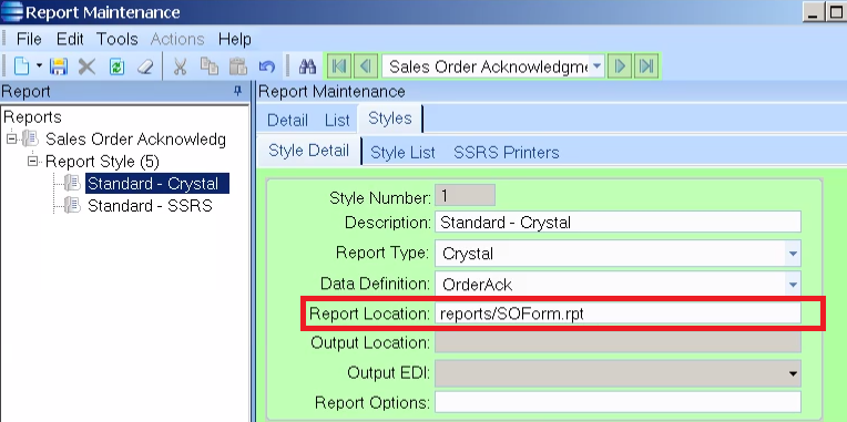

My example below is looking at all the reports for the Sales Order Acknowledgement. The redbox shows the report path for each report style that you have.
We verified the report location but it doesn’t provide the entire folder path. Depending on if the user changed the default install location, there isn’t a way to verify the full path it is pointing to. We are running a stand alone E9 client on a Windows 10 server machine as the appserver client also if that helps.

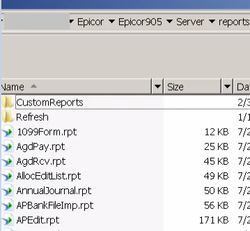

The path is defined in your sysagent settings. “Most” installs point to a folder path similar to this: \Epicor\Epicor905\Server\
Under that path will be a ‘reports’ and ‘customreports’ folders which house the actual crystal reports themselves.
