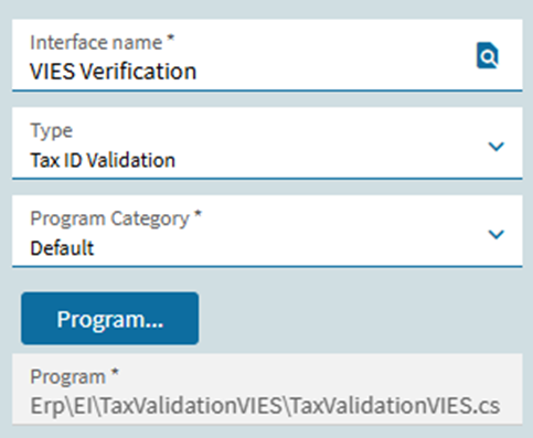

The program files (C#) for verifying Tax ID are located at \[server]\c$\inetpub\wwwroot[instance]\Server\Erp\EI\TaxValidationVIES.
  1. Electronic Interface - Create a new Electronic Interface and tie it to the program for verification.

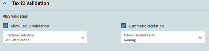

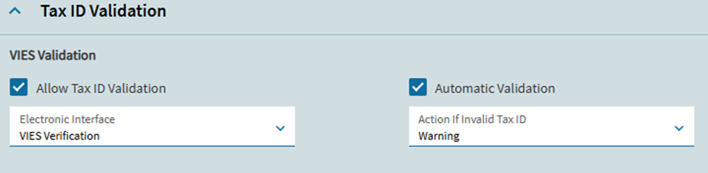

  2. Company Configuration - Click Modules > Taxes > Tax ID Validation. Check Allow Tax ID Validation and use the VIES Verification interface we created in step 1.

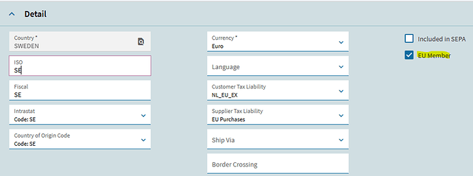

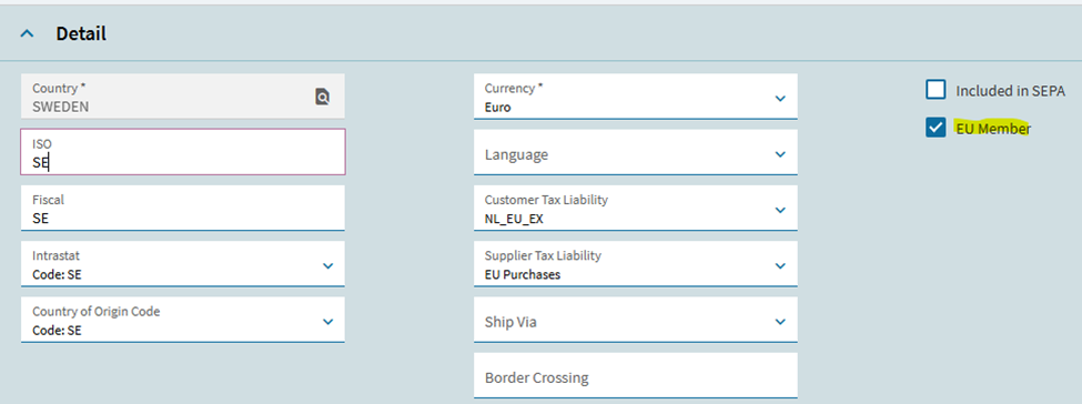

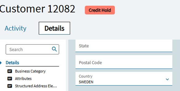

  3. Country Entry – Any country in the EU needs to be designated as such in order for the VIES program to run.
  4. Customer Entry - Test the validation. Ensure the country designated is a member of the EU.

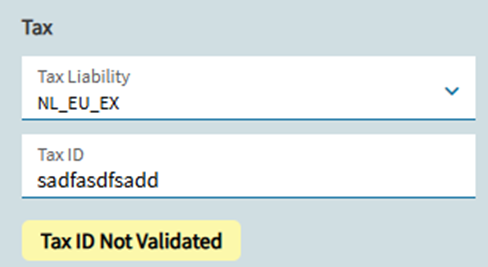

  • Test: Enter a gibberish Tax ID. Result: Tax ID Not Validated

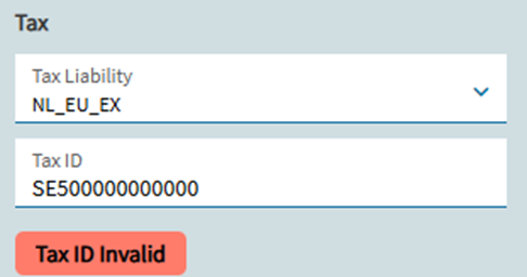

  • Test: Enter a Tax ID with the correct format that is not a valid ID. Result: Tax ID Invalid

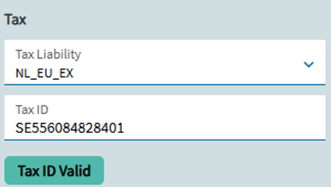

  • Test: Enter a valid Tax ID. Result: Tax ID Valid
