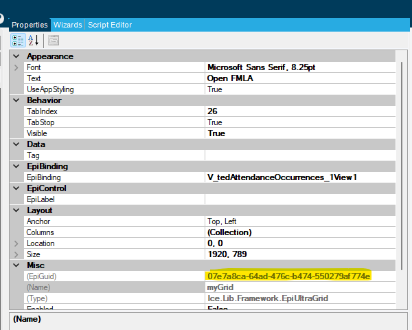

this.grid1 = (EpiUltraGrid)csm.GetNativControlReference(“special code here”);
the special code is here:
then use the form event wizard to create a form load event and add this in the MaintController_Load section
grid1.DisplayLayout.Bands[0].Columns[“Column_Name”].Style = Infragistics.Win.UltraWinGrid.ColumnStyle.URL;
with Column_Name being your column name.

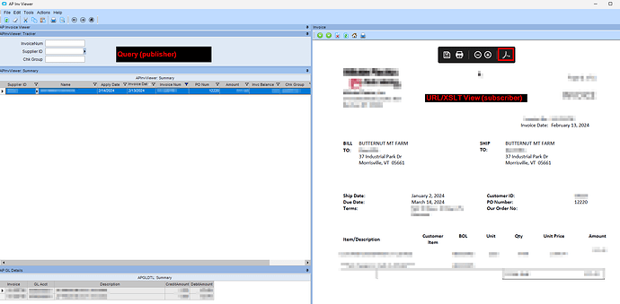

I don’t know if this would meet your needs as you specified a button or something to click. I have a couple dashboards that publish the file URL/link from a query and then use the URL/XSLT view to subscribe to that. This means every time they click on a new line it shows the doc. Works fine for us as they are small files, if you are loading large drawings or files imagine it could slow them down so you’re back to a button or link to click.
