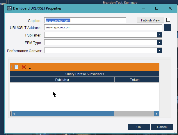

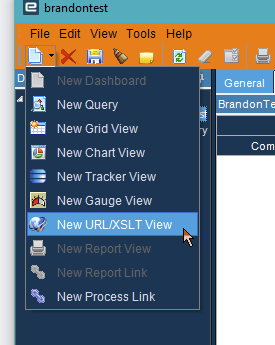

In classic dashboards I’ve used this item
This will render a website, but also picture files and pdfs. I’ve used it for PDFs and JPGs but I don’t know if I’ve tried PNGs before. You can use a publish subscribe with tokens to get your file locations, or web address mapped.

Thank you for your reply, I am familiar with this, and this is what I initially tried to recreate in Kinetic.
