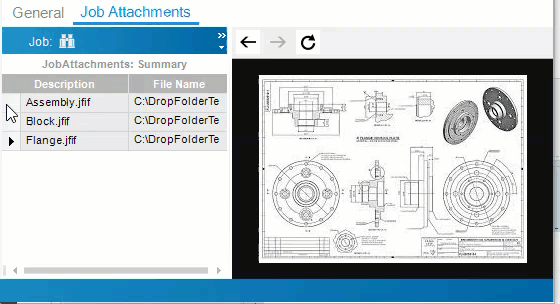

Does anyone know how to view a file in Kinetic?
I have done this on a dashboard and even imbedded it on a job and MES.
with some help from @Banderson

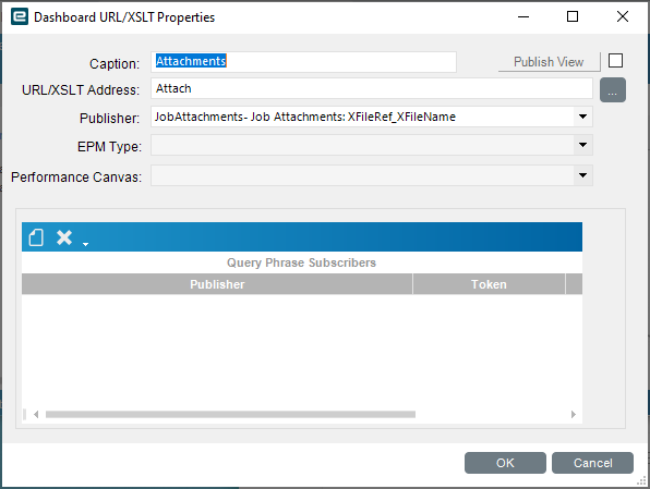

I have tried the WEB Widget and Picture - but couldn’t get it to work.
Assy
The URL link is
JobAttachments.dbd (134.3 KB)
Job Attached files.pdf (256.4 KB)

As my GIF shows, you can look at a lot of files quickly without having to download them.
You should be able to pull the file from any web service. The dashboard above is the Classic UI, did you have a Kinetic version using the web widget?

@Mark_Wonsil - I tried the web widget - and a number of approaches to display the local file.
I went to my browser and entered in the URL “file:///C:/DropFolderTemp/Assembly.jpg” and saw the jpg.
