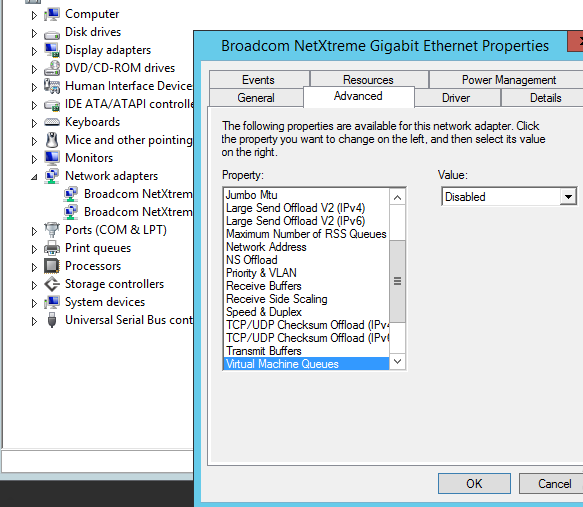

@chaddb do you still have to disable VMQ on Hyper-V?
Just one VM to rule them all!
Yikes! That may be part of the problem. I’ve never ran Epicor that way.
I haven’t been lately. It’s not disabled on our Epicor VMs. It is on some of our other VMs.
